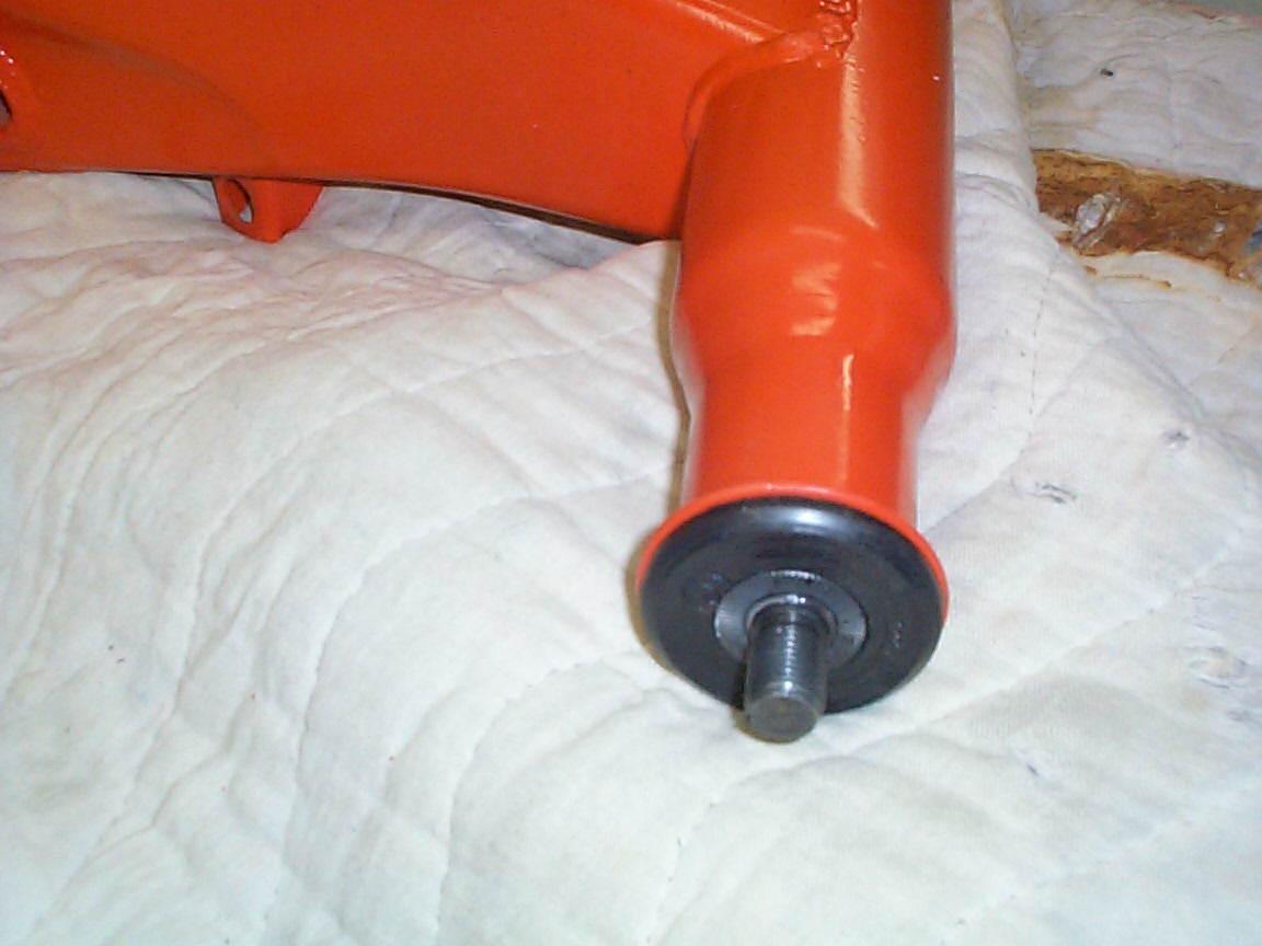

O.K. I have new delrin bushings installed and seems like I remember they stuck out a bit beyond the seration on the pivot rod end. At the time I figured knuckling down on the nut would be enough to catch the serations? Here's what it looked like;

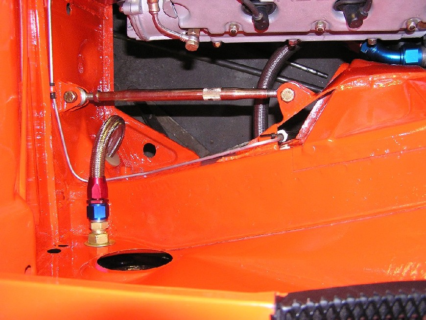

I hope you all know the reason for these nuts to come loose.
I promise you its due to chassis flex
Its a commone occurance on track cars.
you will someday go around a track corner and suddenly rip a CV apart (from stretching)
as you are wondering why or how that could of happened you will notice a big crack in your suspension console.
most likely the right side one.
I know this..
I lived it.
I used to tighen these (inboard and outboard) EVERY single track day for 8+ years
Then I ripped my console out.
replaced it with fresh.. brand new console.
continued tightening those nuts every single day for 6 more months.
then ripped out my 2nd console.
Thats when I learned about the need for a swing arm brace.
Haven't had a single swing arm nut come loose in the 10 years that I've used bracing. Even with 2 drivers doing wheel to wheel club racing.
I use bolt in bracing with aluminum bars.
doesn't weigh much.
comes out easily enough for dropping the motors.
the arm causes side to side flex at the console.
sometimes the console will oval out first
sometimes not..
eventually you will get to enjoy the same fun experience I have.
brant

my -4 cylinder version is smaller and less intrusive.
but here is the basic idea:

Ahh that piece brant.
I thought you have a piece that attached to the actual body, and then to the outside nut. Holding it from moving forward to back (getting rid of toe change)
Andrew.
brant
post May 17 2006, 09:14 PM
Posts: 12,167
From: Colorado
Member No.: 47
I have the toe change brace too...
but that is not the reason your swing arm mounts are coming loose.
its the inner one that flexes and allow's the loosening....
look under the chassis some time.
the frame is straight down the longs.
but when it gets to the swingarm mount it turns sharply.
a TON of leverage is being applied (side to side) on that single bolt.
its the inner one that flexes....
by triangulating the inner one to the firewall you are adding LOTS of strength and bracing....
no one believes me... thats fine.
I like being faster and right.
wait until you have all dealt with a ripped console and then you will reconsider.
the nut comes loose from flex.
(10 years of reality testing proves it... Plus my guru has proven it on 15 other cars)

I think the shaft rotates because the plastic bushings are too thick and don't allow the serrated ends of the shaft to 'bite' into the mounts like they should. I have faced the outer ends of my plastic bushings slightly to allow the ends of the shafts to contact the mount locations.
This is the only reason. We figured this out 20 years ago when we cut our first bushings. The serated ends HAVE to lock into the ear and the outer cup. If the bushings dont collaspe like the stock rubber when torquing the nuts down.. they will come loose. The shaft is NOT designed to pivot in the mounts.
That being said: I shave all the plasic bushings until the serrated ends hang past the bushings. Problem solved.
You should still check them AND the inner mount every event. Also make sure your drains are clean on the bottom of the inside mount.
