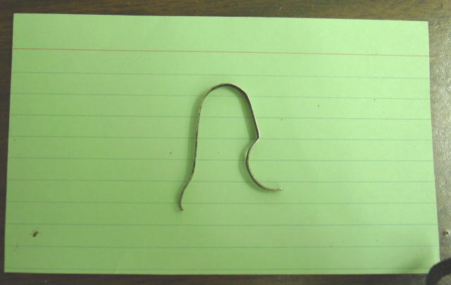

bondo
post Jul 29 2006, 07:32 PM
Posts: 4,277
Joined: 19-April 03
From: Los Osos, CA
Member No.: 587
I have the answer! (no, it is not for sale) (IMG:style_emoticons/default/biggrin.gif)
Rick_Eberle
post Jul 29 2006, 07:56 PM
Posts: 390
Joined: 14-January 04
From: Geelong, Australia
Member No.: 1,558
QUOTE(bondo @ Jul 30 2006, 11:32 AM) *
That's IT!!! Thank you!
