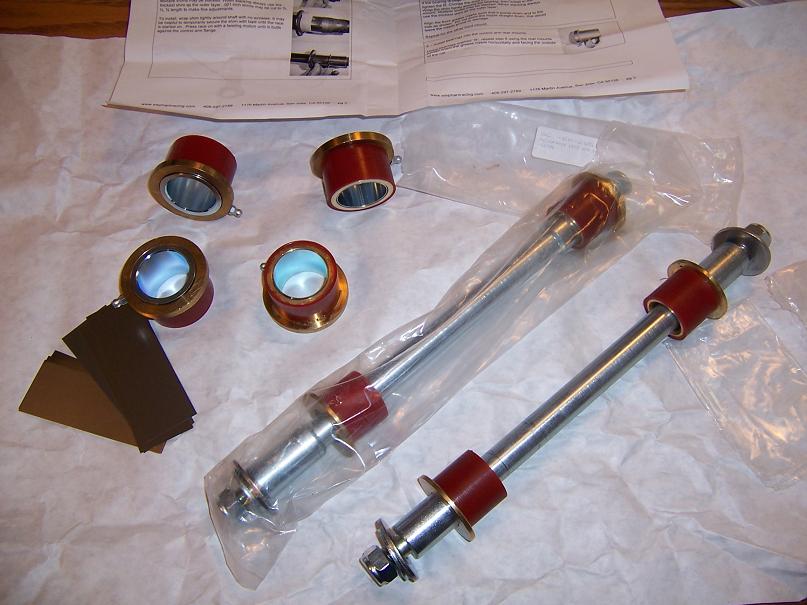

PolyBronze bushing kit comes with bushings to do both front A-arms and both rear control arms, shims and intructions.

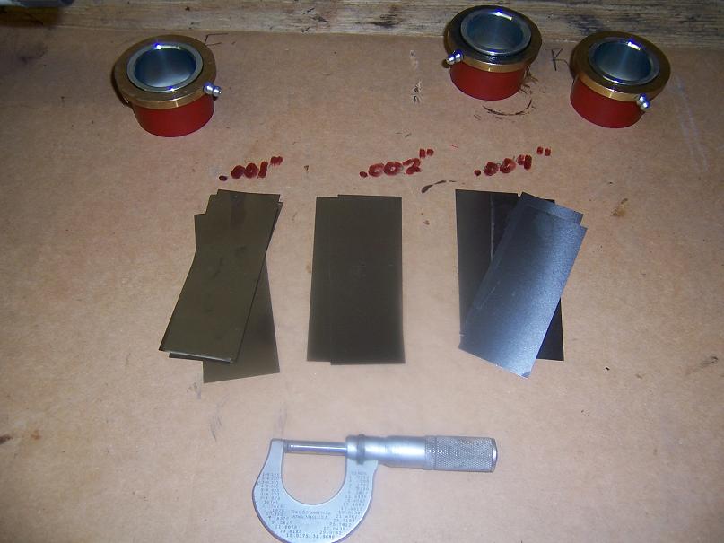

The PolyBronze Front Bushings come with 3 thicknesses of steel shim stock to be used to take up any play when fitting up the inner race sleeve on the control arm. .001" .002", .004"
The bushings are marked for "front" and "rear" meaning the front of the control arm and the rear of the control arm. Don't mix them up.

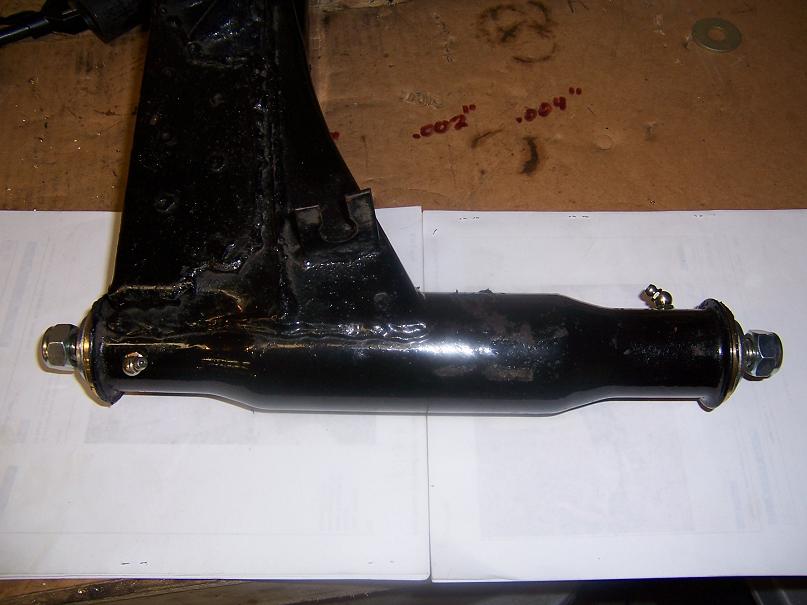

The finished installation.
I let it set up overnight to cure. I tried to remove it using all my strength with just my hand and it didn't budge. Here is the installed arm. Moves really smooth now. No "sticktion".

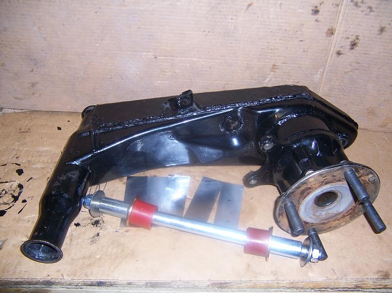

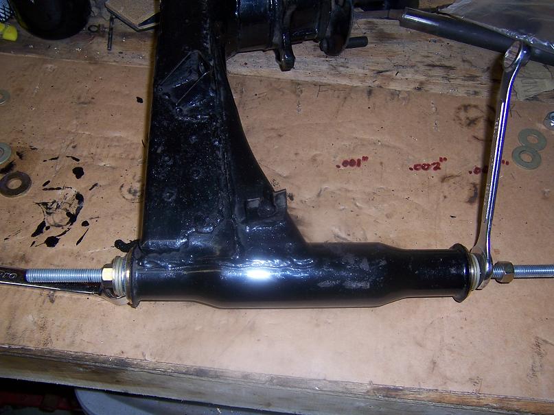

The trailing arm and all the parts to install the bushings.
After fitting up the bushings I needed a .004" shim on one end and no shim on the other. I pulled them into place with a threaded rod+big washer.
Here is the completed control arm with grease fittings. I used a generous coating of waterproof high pressure boat trailer wheel grease during installation.The paint on this control arm is POR-15 I put on there in 1997. Held up great and is still shiny.
