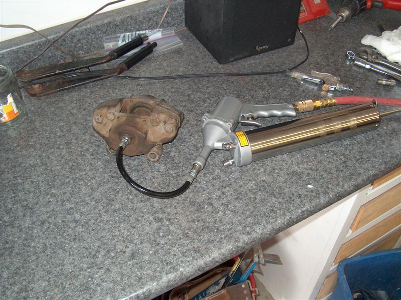

You'll have no or limited luck with PB or any penetrant on a stuck piston. You simply can't get enough at the problem area.
Air compresses, liquid doesn't. The el Cheapo Harbor Freight grease gun has the proper fitting for a Porsche brake caliper. Simply screw off the nozzle and thread the hose into the caliper. (must have air)
You can do it on the car with the M/C but you will have a difficult time popping out one then closing off the bore and popping out the other. Then there's the fluid all over the place etc. That is best done in a vise.
If you have time. Buy a gallon can of Gunk carb. and parts cleaner. You can "just" squeeze an M-Caliper in there. Let it sit 3-5 days then try air again. The piston can come out at quite a velocity as Dave mentions so make sure there's no fingers in there and, stuff a shop rag in there to protect the piston top. I've "never" seen a piston come out of the brake pad/rotor opening so I'm going off the assumption that, while it makes a lot of noise, it's relatively safe.
I keep a gallon can of the Gunk cleaner around for the tough ones. It's now in the $19-24 range though... I had a rear M-Caliper that was cooked. The pistons were S-T-U-C-K. Even the grease wouldn't budge them. I literally gave up on it but otherwise it was a fine caliper. I let it sit for 4 days in the Gunk and both pistons came out with air.

Did you bleed the air out? You need to crack the bleeder until you see grease coming out. The caliper should be full of grease only.
I put a c-clamp on the outside piston and push the inside piston out first.
