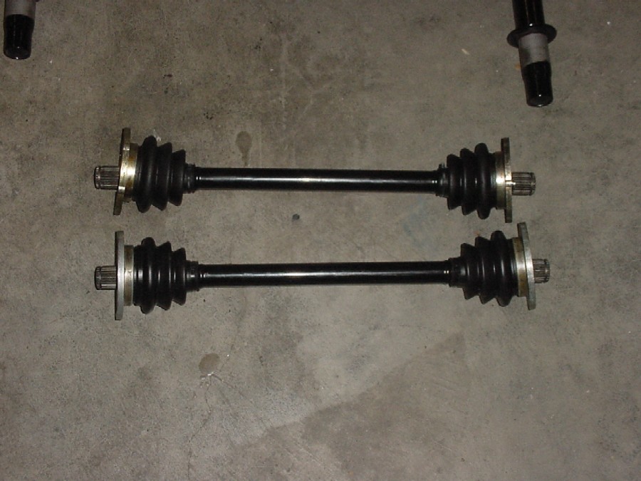

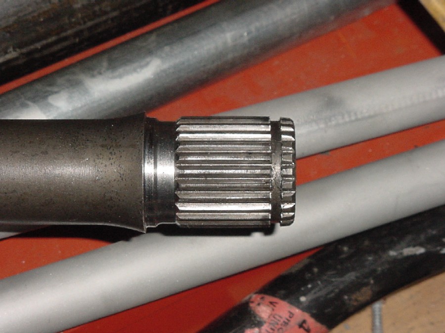

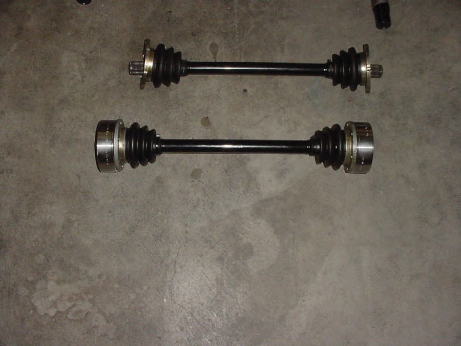

Luckily for me, the 914-6 axle shafts (and hence CV joints) have the same number and size splines as 911 cv-joints. I simply turned the axle shaft shoulders down a bit and 911 CV joints fit like a glove.
New CV joints (and an available supply). I converted the outer stub axle to 911 parts to accept the larger 911 CV joints, and I went with coarse splined transmission output flanges to convert to the 911 CV joints. All factory parts. Just the 914/6 axle shafts were modified slightly.
To answer the original question, NO the 914/6 and the 914/4 CV Joints are not the same, but the complete axle assembly does directly swap.

2 last pics
The Cv joints are for up to mid year 1984 911 parts. (6) 8 mm bolts.
The Trans output flanges are coarse spline 915.
The Stub axles are 911 again up to mid year 1984.
The axle shafts are modified 914/6 axles.
The 944 CV joints are supposed to have the same spline pattern as the 914-4 axle shafts, but again the ends need to be modified to accept the wider CV joints.
I do not know about 944 stub axles.
