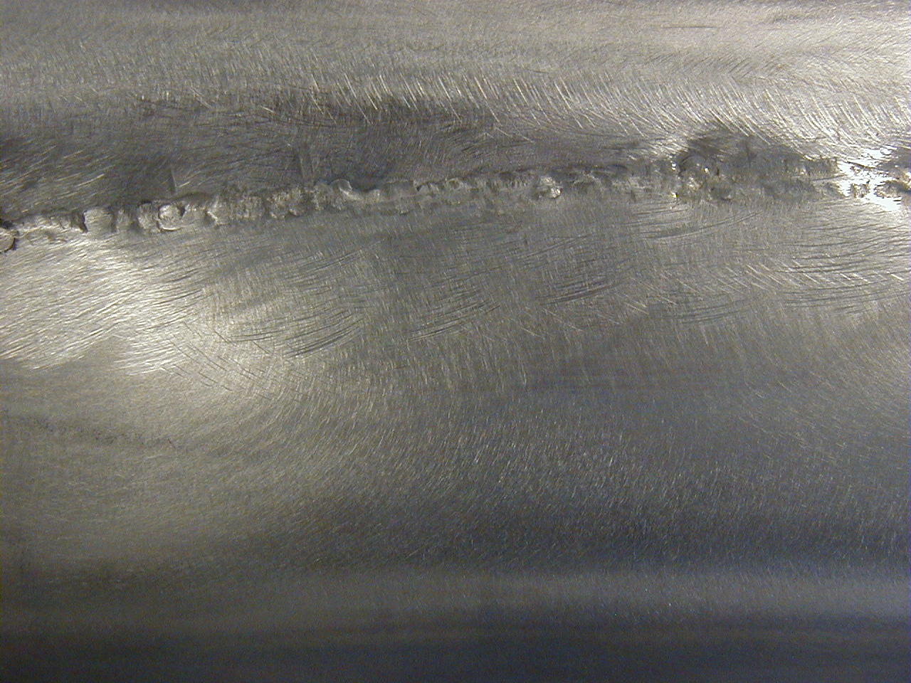

After it's all welded up nice and solid I carefully grind the welds with a flap wheel type grinder. If you use a hard wheel grinder you'll make too much heat and end up with warpage. Grind a little and move on to another area. I also use a spot light under the fender to find any pin holes. When you get done it should look something like this.

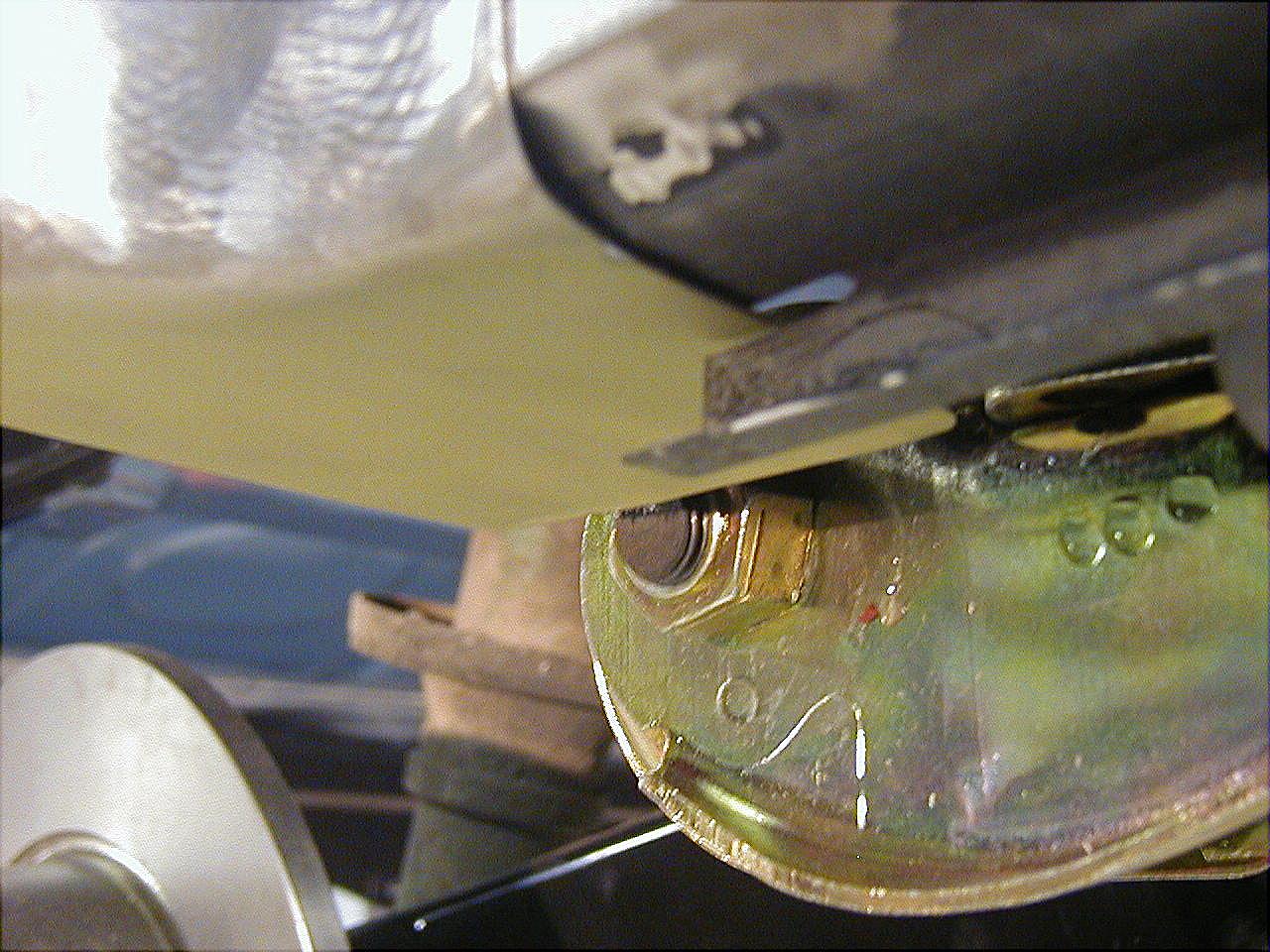

I've never installed an AA set, but the factory flairs don't fit right at the bottom, and require some work to fit good. The factory flairs aren't a great fit in general.
Here's the bottom of the factory flair before any work was done. The bottom edge of 914 panels have a 45 degree bevel, that the factory flairs do not have. I don't know if AA flairs have a bevel or not.

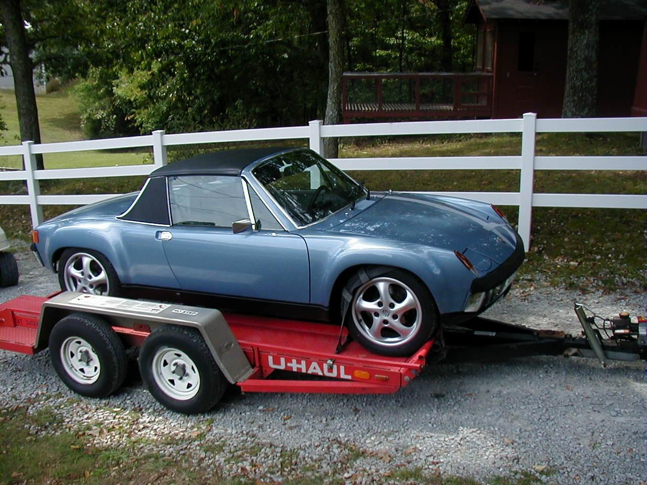

And when it's all done it will look just like this! The owner was happy!
