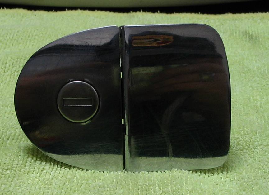

I was re-keying a lock for someone today, and thought it might be a good time to take some pictures & explain how you can do this yourself. It’s not rocket science, if I can do it, anyone can do it. Please correct me if I’m wrong, or use the wrong terminology.
I’ll start with a door handle, because that seems to be what needs to be re-keyed the most.
Your standard 914 door handle.

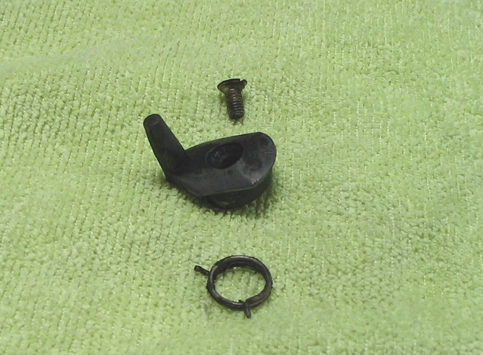

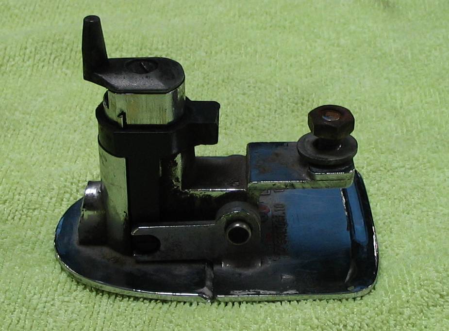

Remove the screw that holds the tumbler in place.
Once the screw is removed, remove the lever and spring.
Insert the key in the tumbler and remove the tumbler.
