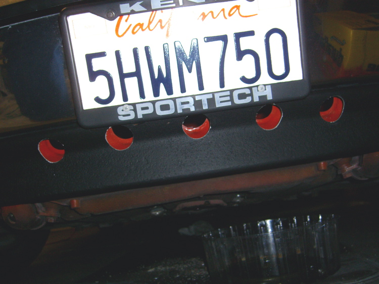

As far as the cooler what is the car used for? If its a street car with 3-4 AX per year. Try hiding the wholes like my pic. I have a 3.2 in a real six I wonted and area that would be very easy on the car and easy on the eye. I drive very hard and up hills whenever the car goes out. I have never seen temps over 205. Just MHO and I live in a hot climate.

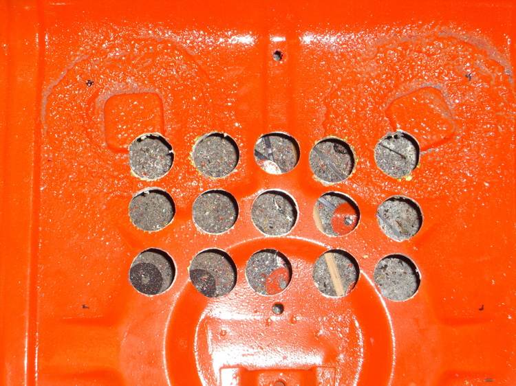

here are the holes that it breaths thru....incoming air, comes thru the front bulk head where the rubber grommets are removed.
DanT
post Jan 18 2007, 07:56 PM
Going back to the Dark Side!
Posts: 4,300
Joined: 4-October 04
From: Auburn, CA
Member No.: 2,880
out the bottom
15 1.5" holes
