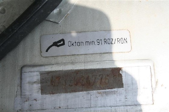

My 74 2.0 came with & still has a sticker up front on the wheel well that says minimum octane 91. Check your drivers manual for that info. I read the same thing about the effects of Meth on rubber & just stay away. My 2 cents.

IIRC there's a difference... 91 roz/ron is not the same as 91 octane on the American gas pump sticker.

91 Roz/Ron = 87 'murrican octane, so 'regular' should work fine. I run mine a bit more advanced, so usually get mid grade to avoid pinging.

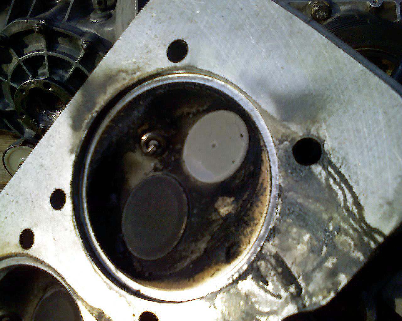

here is what one year of ARCO premium looks like

I was advised to use fuel with techtron additive
the above pic is CA gas that has a bunch of additives to make the exhaust output "cleaner"
