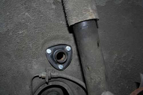

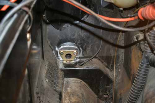

And lastly, how does the location for the sway bar outer and inner plates look?
I test fitted the bar and made sure that the gas tank isn't resting on it, and also
made sure that I didn't put it too low as to interfere with the fuel pump (my car is a '75). These pictures are taken before I removed all the undercoating and paint around the plates so I could weld the innerplate in.

The sway bar mount looks fine. It looks like an after market sway bar.

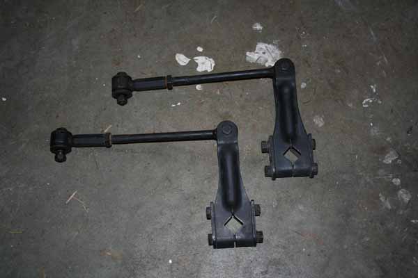

Here's the adjustable drop links for my bar (I verified that the bar is 15mm).
Will these droplinks work with a bigger bar should I go that route in the future?
What's the rule of thumb on setting these up for the first time?
McMark
post Apr 3 2007, 11:37 AM
914 Freak!
Posts: 20,180
Joined: 13-March 03
From: Grand Rapids, MI
Member No.: 419
That's a stock bar with modified stock drop links. AFAIK, no compatible upgrade. Any of the Weltmeister/Tarrett/Smart bars are great upgrades. The Welt and Tarrett bolt into the stock setup, so installation is EASY!
