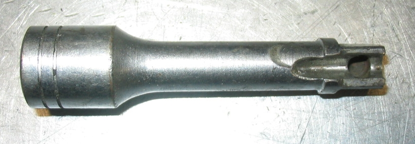

NoEcm
post Apr 16 2007, 01:10 AM
Posts: 95
Joined: 20-June 05
From: Seattle, WA
Member No.: 4,309
This works too (circa 1981 or 1982):
