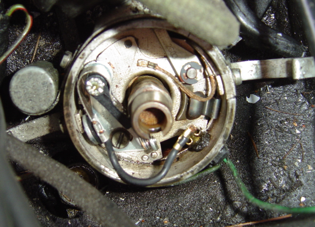

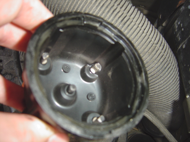

Alright, well I looked at the points and cap and located the condenser and took some pics, I dont really know what to look for (but at least there were no obvious 'well there's your problem' destroyed components.

Do you know how to adjust ignition points? Read that part of the manual and do so. Step 2 will follow...

Those points look worn out... toss em and get a pertronix or crane points replacement.
From the pic the cam block looks like it s gone. (IMG:style_emoticons/default/blink.gif)

Check the timing and check the point gap (or go Pertroix $100, easy to install, usually a good improvement).

Just get new points and adjust them properly and see if that helps before you spend 80 bucks on the pertronics.

Pertronix are worth it, but I have to agreee that it will just put another variable in the problem. Try points, and if it fixes the prob, get a pertronix when you have the $.
