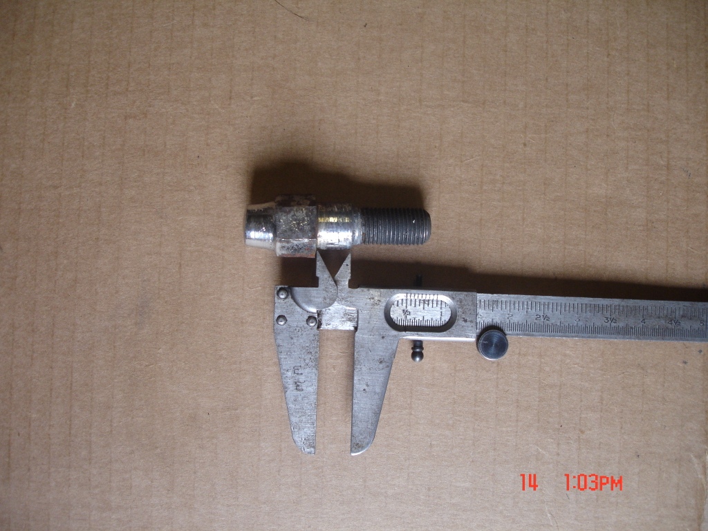

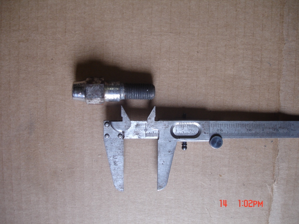

i have some pictures that may help out. they also require thick washers. i have these wheels and would also like to find a source for new.
hope this helps!

Whoa-
I've never even seen one. Thanks for the pictures. I guess you have the dimensions. We know the thead pitch. Hmmm. Wonder if I could have some made?

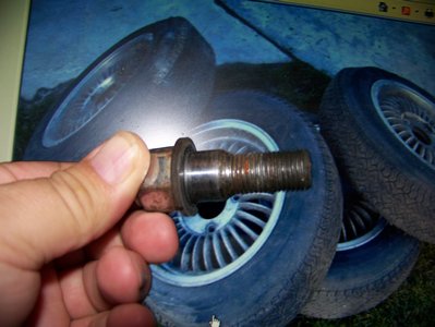

Enkei's also use that type of bolts.
I need one for the V8 car and looked everywhere for one with no luck. Someone on here sent me a couple (thanks again).
The "washer" part is actually part of the bolt head and isn't a seperate piece.

the washers are kinda pressed on, at least on mine. some like the one in my posted picture came off.

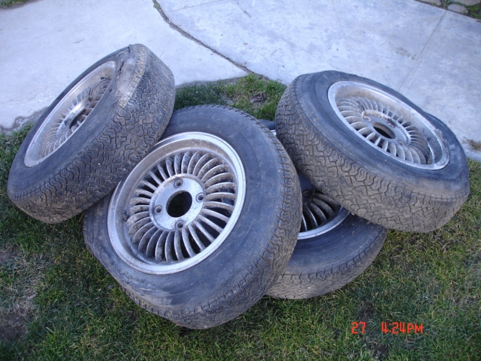

by the way look at your picture of tires. did i send you a couple bolts awhile back?? (IMG:style_emoticons/default/chair.gif)

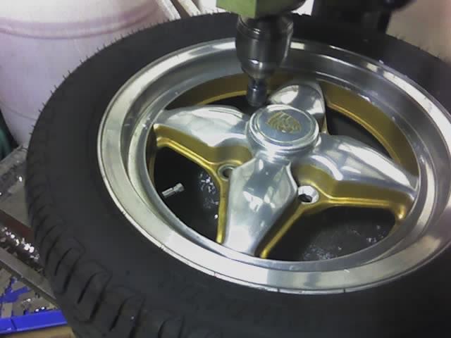

Dudes! You're bummin, just like I was last year. My American Racing wheels had locking lug bolts that were ruined, so I needed 4 replacement lug bolts. Searched here and everywhere for a MONTH and NOTHING! Mine were slightly different than Westerns.
http://www.914world.com/bbs2/index.php?sho...c=60890&hl=
Here's my advice:
1) Measure and post ALL details of lug bolts needed = "washer" OD, thickness; flange OD, length; thread pitch, length; total length, etc
2) Search google for "Mag seat" lug bolts. Gorrilla makes some, EMPI, and others
3) See above....I eventually had my alloy wheels drilled to accept cone seat lugs. There was about 3/4" meat of alloy at the hole to work with, and a standard 60 deg countersink bit did the trick.
Using cone or ball seat lug bolts in the flat mag seat holes will eventually grind down the hole resulting in cracked holes/rims. This happened recently on a track/AX 914 in NorCal that used ball seat lugs on steel rims.

The bolt that is in the picture with the calipers is available at J.C. Whitney or Pep Boys. Bought a set for my Jensen Healey with aftermarket western wheels there last week.
