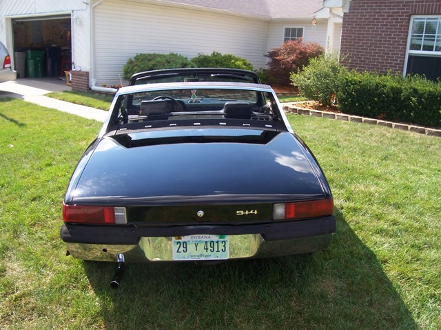

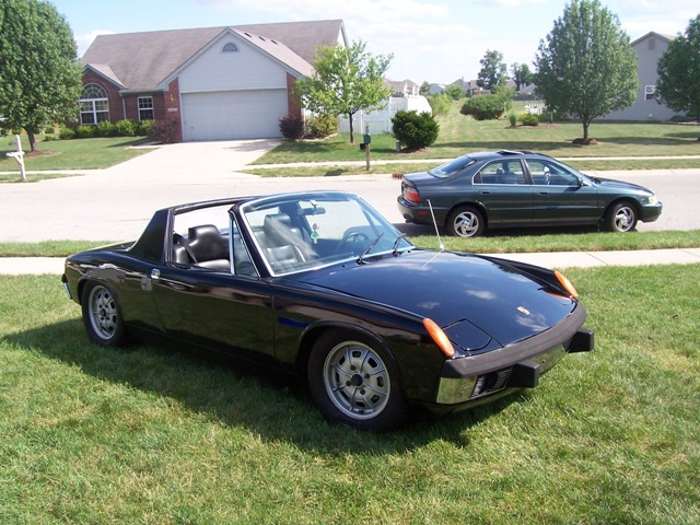

My car does have the appearance package. Now whether this was on the car from the factory or not is up for debate. (IMG:style_emoticons/default/smile.gif)
This car has been gone through in the past, so I am not sure what has been added. Also you will notice that things are missing as well (side markers, side mirror, etc). Unfortunately I only have pictures of the outside available here at work. But hopefully it will create a starting point. I will add pictures of the interior later. Also, this car will be going through a complete teardown next fall (I want to (IMG:style_emoticons/default/driving.gif) it for at least a little while) because as you can see it is a bit rough and does have a few "minor" rust issues I need to deal with.
OK....blast away!!!

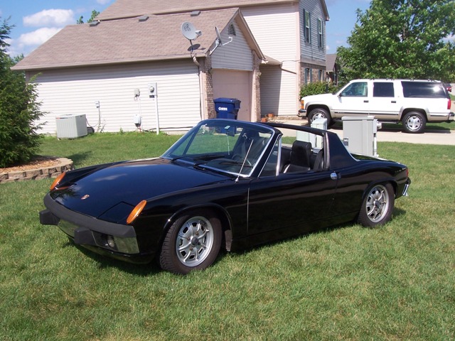

One more....

Troy,
It looks pretty good in the pictures.
First, the color black (code L041) would be approriate to a MY 1971. To find out if the color is the original color, check the chassis/color tag in the front door jamb, on the drivers' side.
As previously stated, you can get a Porsche CoA to determine the primary equipment and color configuration for your 914. That will also provide an engine # so that you will be able to tell if you have the original engine in the car.
The Pedrini alloys on the car were optional in 1971, so they are correct for your MY.
The chrome bumper on the front is a 1974 piece as evidenced by the black "guards' or "tits" on them.
Assuming that your car is a USA-spec model, yes, the front fenders should have side marker lights on them if you want to be authentic.

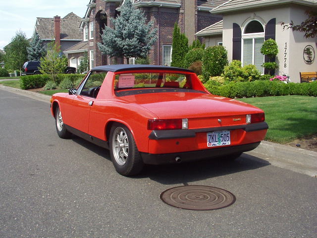

Here is an original '71, however no appearance group. Notice rear bumper is the later style (early "square" indent was '70 only) and no 1.7. Gold is correct for the "914" badge.
