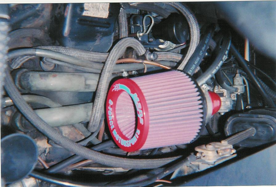

I have the Autoatlanta type intake. It's not a ram air system, but a bigger/higher flow filter. It makes more noise, you can hear the air sucking in. As far as performance, it doesnt hurt, but it's not a magic hp wand.

The changeover to a cone style filter has its ups and downs. The ebay $10.00 offshore specials are known to have a high rate of restriction, and usually look like they have sucked-in on themselves. One of our customers has seen one (offshore) disintegrate and small portions of the filter suck into the engine.
We have been developing these since 1997, and using only U.S.mfg. S & B filters, see www.thetruthaboutfilters.com
Even Green Filter Co. covertly came over to S &B in the late '90s for a "Tour" (lol) .
On normal aspiration cars, every little bit of CFM helps. Our '74 914/ 2.0 CI car ran 1.40s at Willow (streets CW with Bowl). With only the filter changed to our short ram /S&B and a basic oil change and tuneup , we ran a 1.38 (CI record) and
we will proll'y top that in Nov. That's 2 seconds per lap faster with a small investment. This is also the same unit that AA markets.
But throwing on just any cone filter will not do it. Buyer beware.

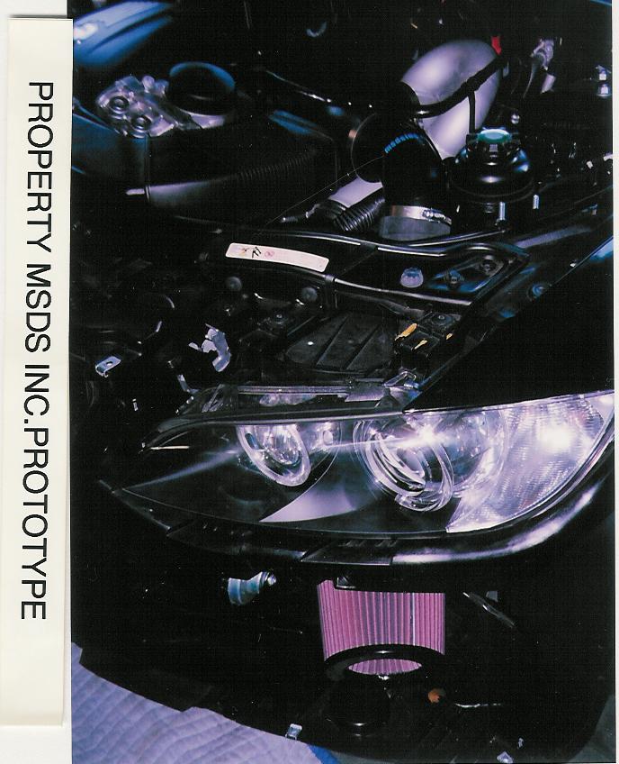

Turbo engines benefit even more from the cone filter. These engines crave massive doses of cfm airflow when spooling up boost. The technically managed engines cool the compacted/heated boost air with efficient intercoolers...bringing denser air to the cylinders.
Case in point: the new BMW 335i twin turbo inline 6, makes good power right from the dealer . Our short-ram style cone filter makes +12.89 RWHP over stock, and our cold air attachment yields a few more.
These BMW owners are still in denial that we could build a better air filter system than their Munich engineers.
Again, almost +13 RWHP for a small investment. Not to mention a cleanable/ re-useable filter, excellent throttle response and nicer engine sounds.

...the cold air attachment for the turbo 335i. Car has an incredible spooling sound...not like the Subys or Mitsus. Gale Banks recently did a show on Speedchannel, and he was talking up +1 WHP for every 10 degrees cooler of air delivery temp. That's even more free hp !
