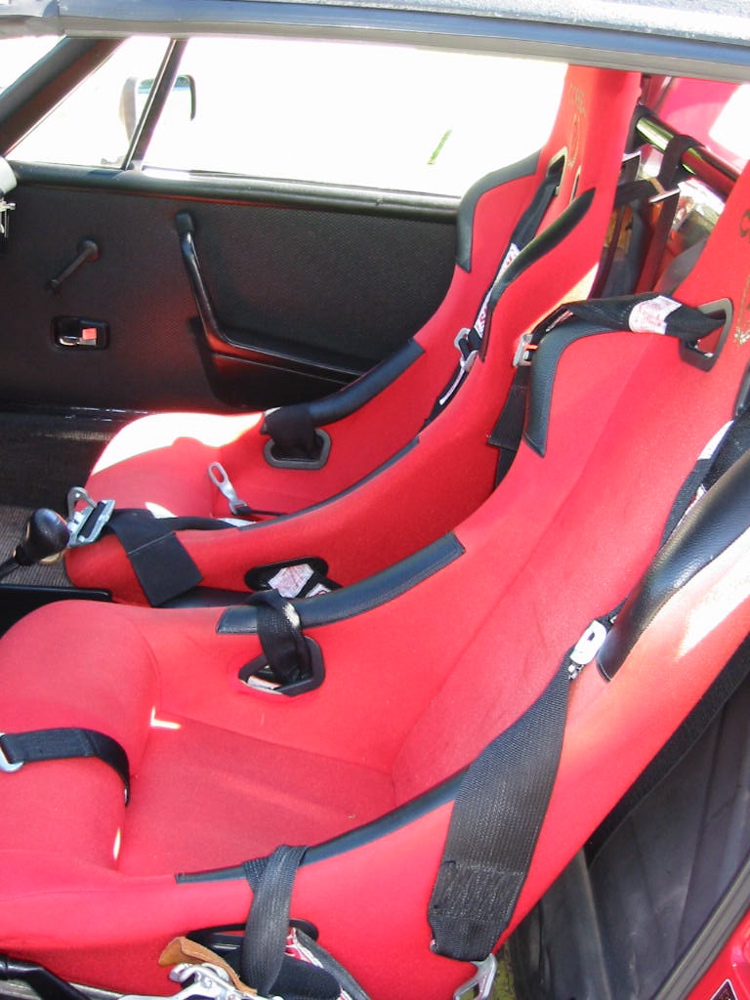

As I am customizing my project car I am going to put better seats in it. I have seen S2000 seats in a teener and they looked good but the owner said it was a tight fit. I see all types of aftermarket seats on ebay in the $300-$500 range after shipping but will they sit too high?
914 seats are very low to the floor and being 5'11" I don't want to look at the windshield frame when I drive.
Who else has put something else in a 914 and how do they work?

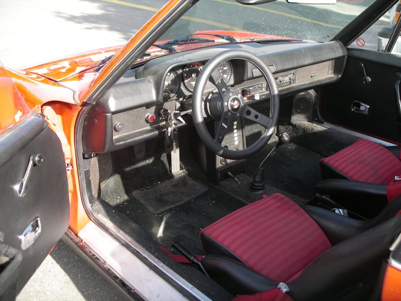

here you go...
Corbeau Classic IIs
sit about the same height as the stock seats. bolt right onto the stock seat rails (IMG:style_emoticons/default/biggrin.gif)

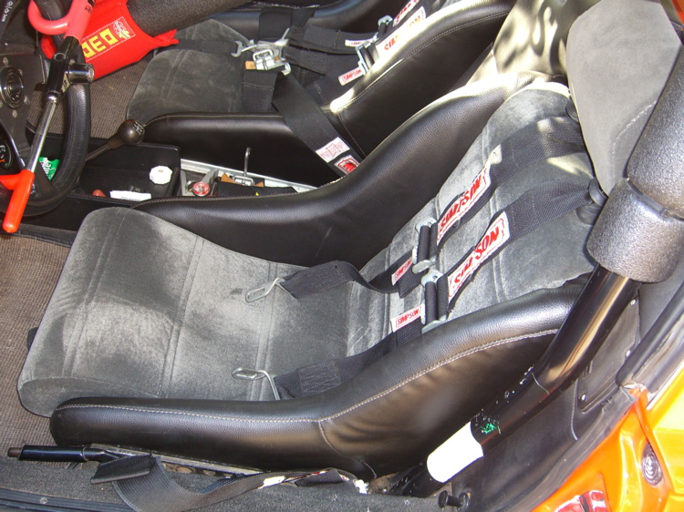

and

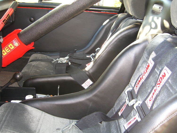

had Corbeau Forzas but the sit up too high (IMG:style_emoticons/default/sad.gif)

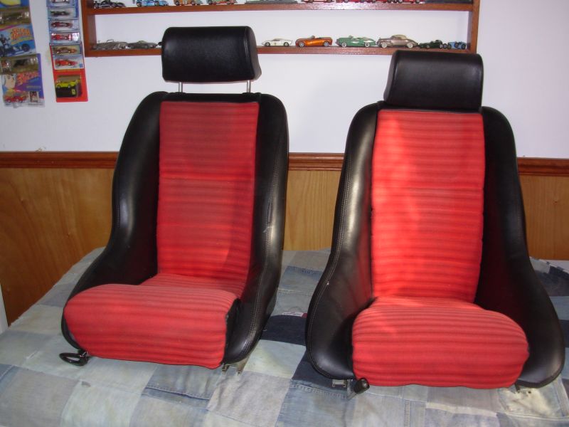

If you want to spend some $, I have the Original Recaros out of the Strenger Gt. Comfy & period correct
T.C.

Hi Dan, those are nice seats (Black Corbeau's). That is kind of the look I want for my car, they bolt right in? And are nice and low like stock? Are they still available? Wonder where I could buy some. Thanks
DanT
post Jan 22 2008, 09:18 PM
Going back to the Dark Side!
Posts: 4,300
Joined: 4-October 04
From: Auburn, CA
Member No.: 2,880
check here http://www.racing-seats-usa.com/
still available brand new....I found mine used but in very nice condition.

QUOTE(Dan (Almaden Valley) @ Jan 22 2008, 07:18 PM) *
Dan,
Are these legal per the rules? I thought the seats had to have provisions for the belts...
-- brett
(I am using a Kirkey seat. Absolutely no problem with height, actually, I had to build the bracket to get the seat high enough!)

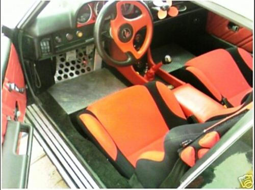

I wonder if this would work (IMG:style_emoticons/default/idea.gif)

QUOTE(Dan (Almaden Valley) @ Jan 22 2008, 05:59 PM) *
here you go...
Corbeau Classic IIs
Dan,
I was under the impression that the Corbeau Classic IIs sat a bit higher than the stock seats. Also, how well do they fit the backpad? Do you perhaps have a photo?
The Corbeau Classic IIs seem to me to have slightly better lateral support in the upper back than say the Le Mans GT seats. I sat in a demo Le Mans GT seat at the Porsche Auto Fest in Ventura last year and frankly found it to be a bit lacking in lateral support other than in the butt. They are also about double the price of the Corbeau.

I have the Corbeau Classic II's and really like them a lot. Andy is right, they do sit higher than the stock seats. It was something I noticed as soon as I sat in them the first time.

I just removed two Classic IIs from my car in favor of the Forzas because my PCA chapter would no longer pass me on tech inspection w/o the pass through for anti-sub belt. I was told I could not modify the lower cushion. My car does not have a back pad. They do sit higher than stock seats, but are quite comfortable. I'm 6'0" and my car has a formulring (sp?) steering wheel that is smaller diameter than stock. I imagine that a stock steering wheel will make for a tight fit with the Classic IIs.

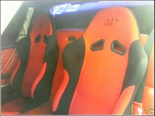

I'm looking at something like this.
Ebay seats for Jetta
or this
