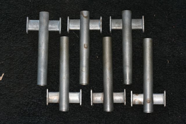

QUOTE(brant @ Jul 17 2008, 10:42 PM) *
by the way, you can get GE grinds for 3 bearing set ups
cool deal, good to know!
most of the guys I know run GE60's on the street
the GE80 is a little milder than a RSR Sprint cam and one of the contending profiles for my 2,8.
...by running tall 2ndary venturi's
did we ever establish if those are available for 46's? 'Cause I have a pair of those in case I get impatient while saving my nickels & dimes for an RSR MFI setup...
brant
post Jul 17 2008, 10:09 PM
Posts: 12,167
From: Colorado
Member No.: 47
[quote]
...by running tall 2ndary venturi's[/quote]
[/quote]
Rich,
I know they exist
I wish I knew you were looking
my buddy just sold a set about 3 weeks back.. fairly reasonably too...
(his were running on a 906 cam'd 2.0/6 GT 914 racer)
