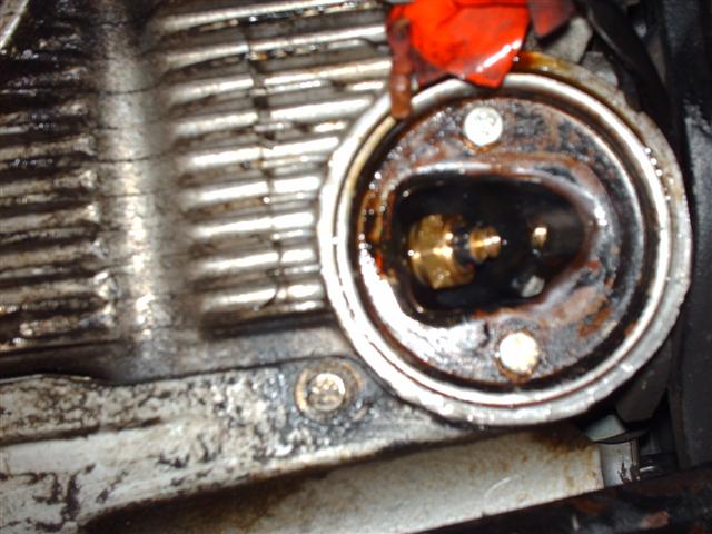

Also it reads temp right where the stock sender does, (if' you've ever had the temp sender plate off you can see the bottom of the dipstick) so the temp readings are taken from the same location.
I used the dipstick gauge to give me real time readings from the stock gauge in the car... After a few drives and stopping to check the dipstick gauge, you can see where the stock gauge is, and get a idea of what the non numbered gauge is telling you.
One warning though, it will make you nervous, as I could not believe how hot "normal" was on the stock gauge. Straight up and down, on the gauge with the small red zone is right about 215, if the needle is touching the "M" on the word TEMP you are 235-240ish and if you are on the P it's 250 and above, all below the red zone.
