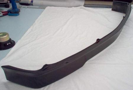

Spotters guide: There are other differences, but here some basics to help you recognize them from a distance.
The factory valence has this part number molded proud into the inside center surface, aftermarket does not. The numbers are about 1/2 in high, near the bottom edge. The VW symbol is dead centered on the valence. This part is NLA. The inside surface is raw white plastic, not painted.
The factory valence has 2 metal angled support braces and hardware, aftermarket does not.
The orange valence in these photos is factory, the black one is aftermarket. There are several different aftermarket companies making these so called 'LE spoilers' and each one is different, this black one I show is only one of several styles. Look at the photos for differences in details and quality.
I have not seen a believable aftermarket unit, but I would not think these would be hard to copy perfectly. Can anyone here mold these and repro an excellent copy? I bet there are some LE owners who would want good repros, only about 25% of the surviving LE cars still their have factory spoilers.

The originals are fairly thin, only about 1/16 - 3/32 in. thick (wheel well edge and attachment points are thickned), in a hard, dense resin plastic, fiber-reinforced, and molded smooth on all surfaces. The valence seems slightly more brittle than fiberglass, but it would be subtle if at all. They do look injection molded. Would injection molding be easier/faster than laying up fiberglass, when the factory made them in production quantity? How do they made corvette body parts - injection molds?
Could a good mold just be made from the original part using a mold release? At least the outer surface and the proportions would be exact, the inside really is not that important or visible.

I have a factory LE spoiler on my 76 car that came from the factory with it. It had a small amount of damage on a corner so I bought a copy to put on till I get around to fixing it. The copy that you show is a good copy as copies go but it is a copy. My wife could not tell.
As I have been in the plastic biz for 34 years and 3-d molding of polyesters as one of my specialties over the years I have thought on this. The factory part could have been cast under vacuum or pressure. When you close up a part that big the tooling starts to cost a lot compared to fiberglass layup tooling. The precision that you get is dead nuts on but cost a lot.
