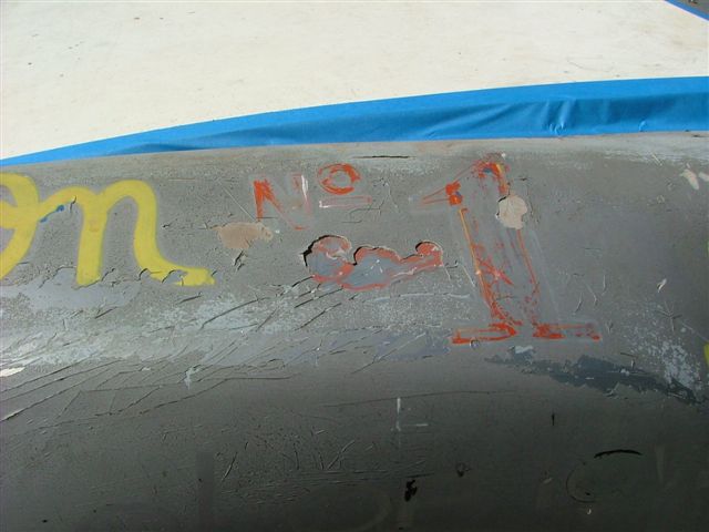

Did you take detailed photos of the graphics? Do you care?
That's the only thing I'd add... Godspeed. |

I did a car with hand painted graphics and used trace paper , then the sign painter redid em exact.

I did a car with hand painted graphics and used trace paper , then the sign painter redid em exact. I was planning to get good photos of all the graphics, but full size tracing sounds like a good idea as well. T.C. located the jewelry store in Miami that was once the sponsor, but they seem to be out of business now. Maybe if we can dig up the address, some World member in Miami can swing by and see what they can find out??? John |

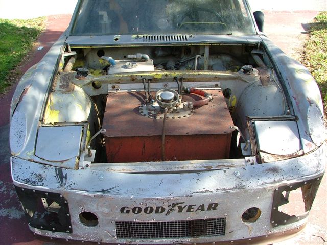

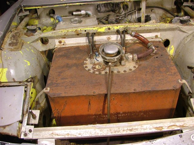

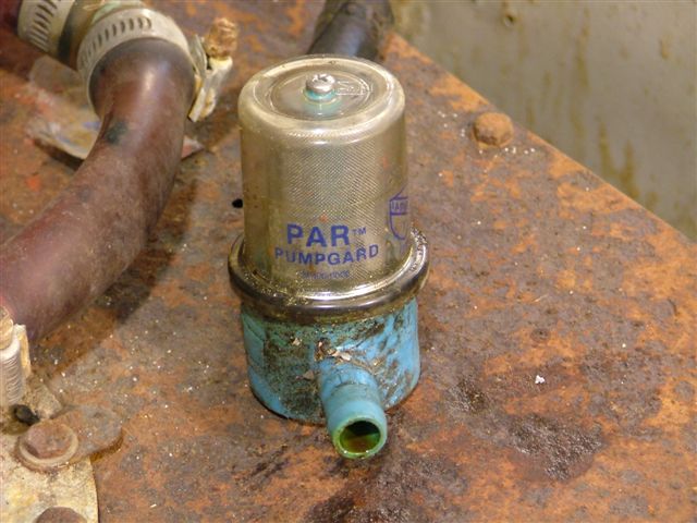

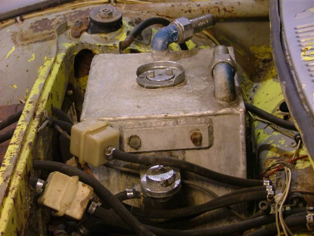

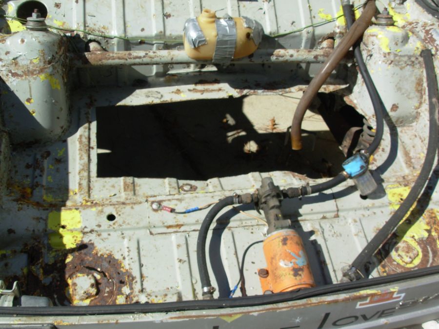

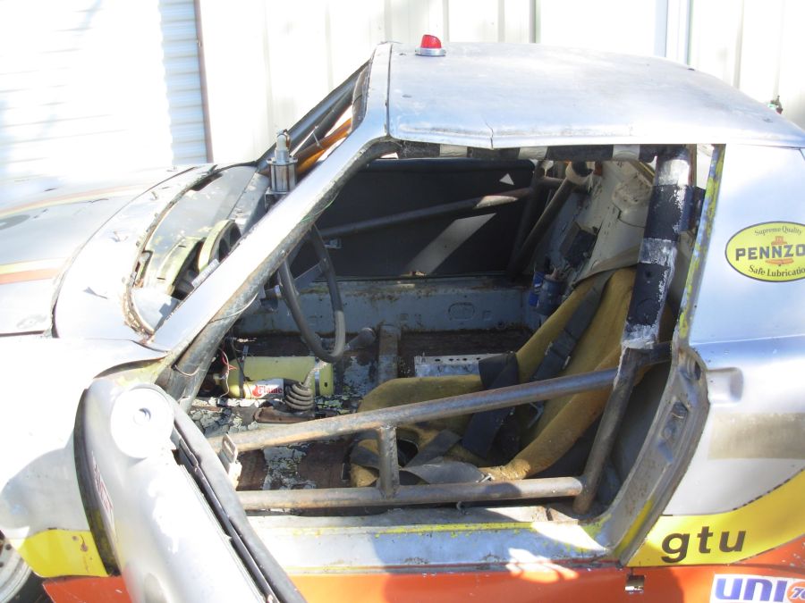

No, T.C., I have not done that yet. I have worked every day since I picked up
the car from you. The big crunch should end in 10 more days or so. Then I plan to take off a few weeks and make some progress. Here are some more pictures. I got a lot of great advice on taking pictures from people, not all of which I have been able to implement yet, but most of these are ok. First thing I did was to take apart the fuel system. ![]() Here is an oil filter that was loose inside the car. Is this company still around? It looks like a stainless screen filter, do people use these on the 914-6s still? ![]() Notice the dual fuel pumps, filters, and relays. These connect to a fuel pressure regulator and then to the normal fuel line in the tunnel. Don't know if the plastic lines are in there still. ![]() This is the custom made oil tank. You can see the fuel pressure regulator, which is bolted to its side. It has a range of 1-6 pounds so the car had to be running carbs. Geez, I sound like I actually know something about 914s, ha! ![]() I know just enough now to realize how much I have to learn. John |

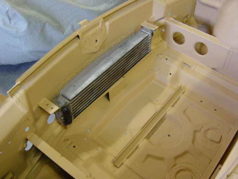

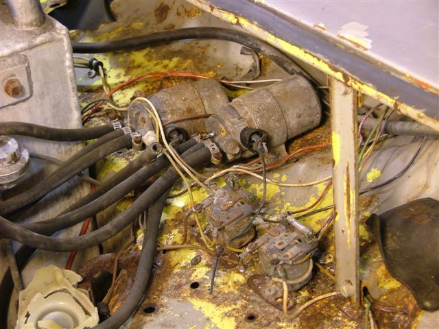

John, That Par filter was actually in-line for the tranny cooler at the rear of the car. The lines were all brittle and when I was stripping the trunk I took that filter off.
The best I could tell the car was running a Twin-Plug motor due to the twin ignition boxes & Coils that are attached to the firewall where the passenger seat would be. I'm sure they were running carbs. T.C. |
