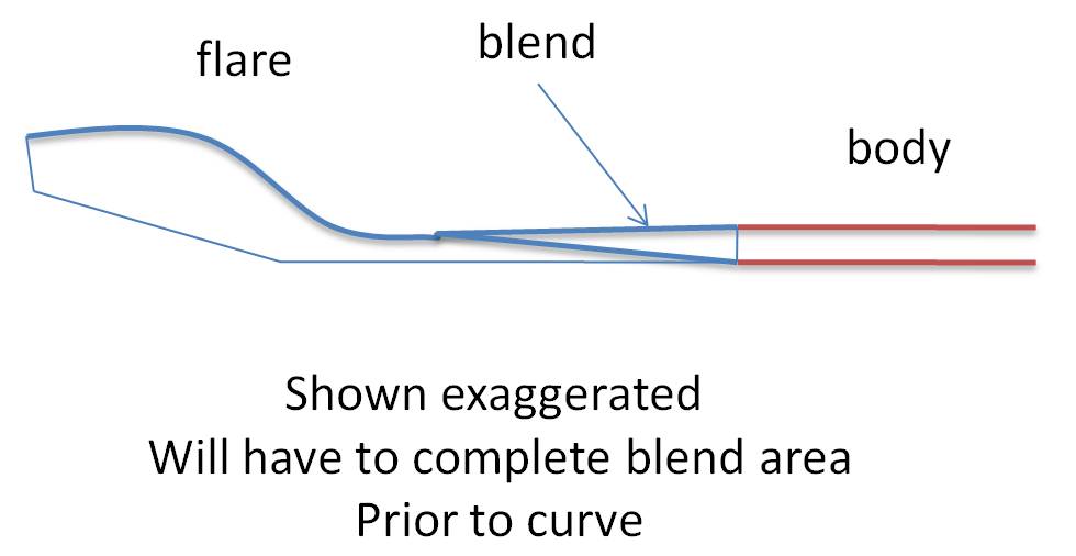

...while letting in of the flare to the body, I noticed something, and I just have to mention it. When I saw that the section shape for the flare was not the same as the car, I knew a blend as in order but didn't know how far to take it. I have attached a simple example of each section, and a jpg file from Patrick Motorsports and how they handled it. In simple terms, their photo answered my question.
It just seems that everytime I get a warm and fuzzy, something puts hair in my soup.
The sketch shows the section of the flare (in red) and the body section (in blue). My concern is the angle part of the section. There is enough material to form the channel.

First off, I'm not a professional body guy!!
After welding on the flares, I ended up cutting off the bottom sections (all 8 of them), modified the sections as required and then welded them back on.

...thanks for sharing your flustration with us....I feel exactly the same way...
I went to your website, and yes, I too have the same problem with the flares.
I believe that the angle carried through the flare from the Patrick motorsport photo is of a full flared fender. If it isn't they did an excellent job of it.
I believe that I can make two cuts and form and reweld without removing material.
However, the curve that you moved disturbs me, because mine is also too shallow. Great! It became more than I thought.
Another thing I noticed last night was that the flat face of the rear flare on the passenger side is nice and vertical, and the driver's side rear flare is angled toward the top at about 5 degrees and not so vertical.
This has become more of a battle than expected.

Don't get too crazy or anal about it.
I don't think there really is a "perfect" installation that can be used as a model. I've seen some flared 914's that are totally beautiful and works of art, but I've no idea if they are as the factory intended. (I think the factory fudged it also)
I was worried about it for quite some time and finally decided to just jump in and do it.
That 5 degree tilt may be normal.
