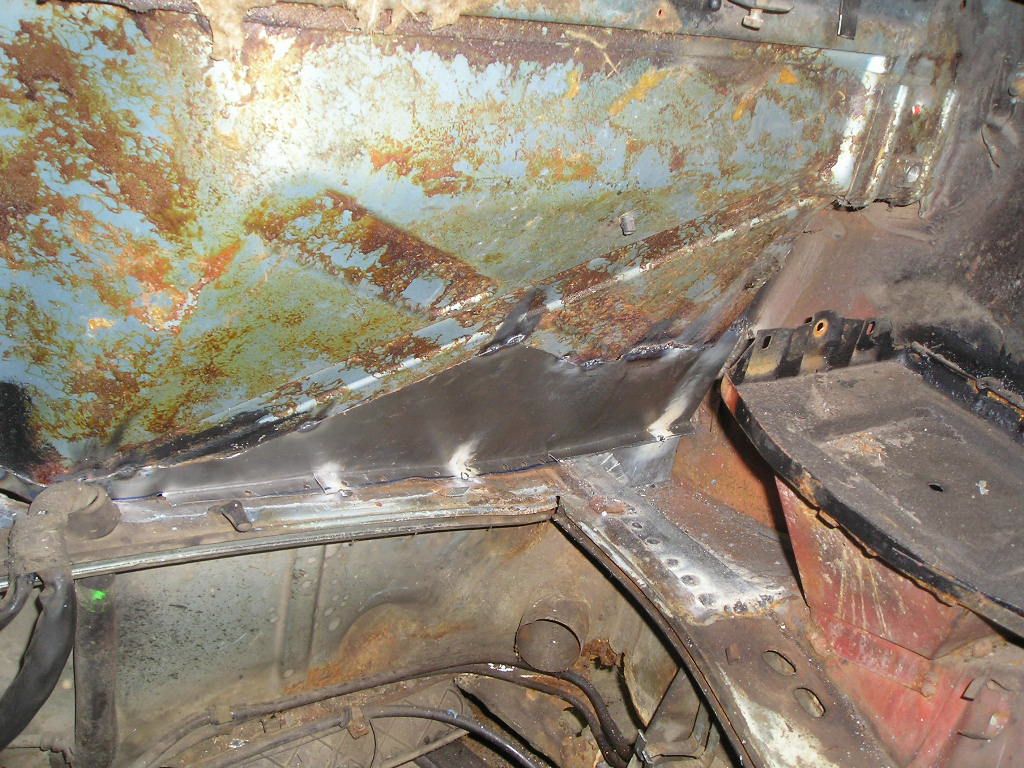

I got some more work done this past week. I am done with traveling for a while so I will have more time to work on the car. (IMG:style_emoticons/default/smash.gif) I started repairing the driver's side fire wall. It pretty much had the same rust as on the passenger side so the repair was the same.
This is what I had to work with after all the bad stuff was cut out.
Here are the first two pieces welded in
and the third piece
Shot from the back
Hopefully I will get the big piece in tomorrow. In the last picture you can see some rust in the side wall and I will take care of that when I cut off a portion of the rear fender. I need to do this anyway to access some rust in the long.

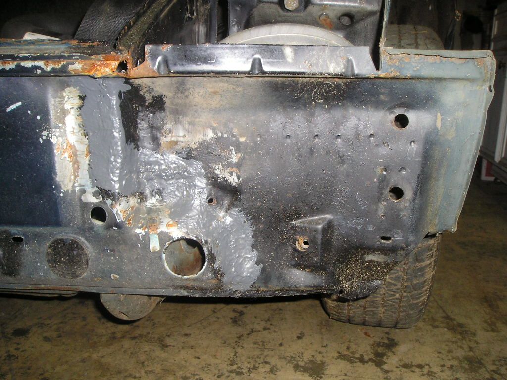

So here is what the driver's side jackpoint looked like before. Doesn't seem that bad right?
Here is all the rust exposed
And then after a little handy work
And finally with the fender tacked in place.
And one more for the road
