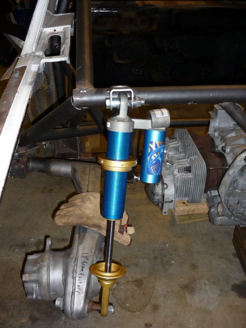

I have an extra set of Dynamic Suspension canister shocks that I want to sell. You can mount them either way. They are double adjustable. Fully extended they are 18 1/2" .

Thanks for the offer can you drop me a PM I think the problem will be the cansiter Fitting into the space I have to work with. PM price and any info you have Or Heeltoe914@aol.com

Dang Blake that is nearly exactly how I mounted the lower eye of my shocks. And I never seen your set up before.

Those lower mounts were made by Carrera when they were still in business. Direct bolt in units.
