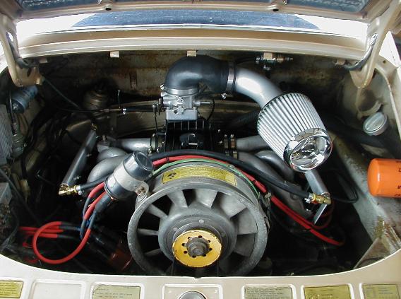

Ok. Here's a picture in a 911 of what the finished conversion should look like. (I pulled this from Tony's site, after getting permission.) Tony also knows about this thread, and we may see some comments from him.
-- brett
