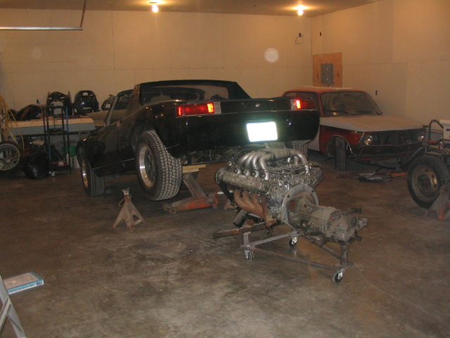

post Sep 11 2009, 07:22 AM
Hey nice rack! -Celette
Posts: 21,291
From: Now in Superior WI
Member No.: 43
This works for me.
