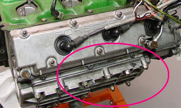

I am starting to button up my 2.7 after getting everything cleaned up. I noticed on the PP site that Wayne had to remove a significant amount of the cooling/structure ridges on the lower 930 valve covers. I was surprised at how much material was removed. Is this a “every 914 is a bit different” type mod, or is it always something that needs to be done? Can I simply use a dremel? I don’t want to warp anything….

Here is the pic Wayne sent me. He said he only had to do one side – but I had heard other variations. Thats was why I was wondering about each car being different. I will do this to both sides to make sure. (IMG:style_emoticons/default/sawzall-smiley.gif)

I would do both sides, IIRC one side I did slightly less, but if I did it over, I would do it just like that pic, much cleaner looking.

I did mine like the pic shows; did both too. Take your time grinding as it cuts fast. Pretty easy mod and unless you want to drop your engine every time you need to remove them, you'd better do it now.

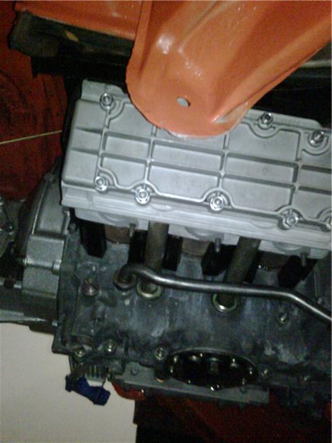

I will need to see one of your rides. The two pics above are confusing. Waynes pic clearly shows the valve covers being gound on the fan side of the motor. Sixnotfour, in your pic it appears that they need to be done on the tranny side of the motor (based on where the suspension ear is in the pic).
EDIT: think I will just do the entire thing as per Perry's post to be safe.
Thanks a million everyone. very very appreciated.

tranny end gets the grind; you can access the nuts up front no problem
