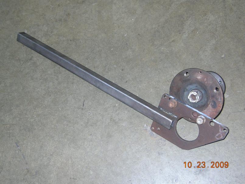

I use a 4 ft long piece of 2 inch angle iron, drilled for 2 lug bolts. Propped against the ground, it provides plenty of counter force for the socket, breaker bar, and "extension" (cheater). My bar is drilled for numerous applications, such as flywheels, 4 and 5 lug drums/rotors, front pulleys, and such. The Cap'n

I forgot to include in my post that you do need to have some way of holding the hub stationary.
I also drilled angle iron to fit over the studs on my 914-6 to hold the hub stationary by having the long end resting on the ground. When I went to remove the nut, it did put a slight bend in the bar as well.

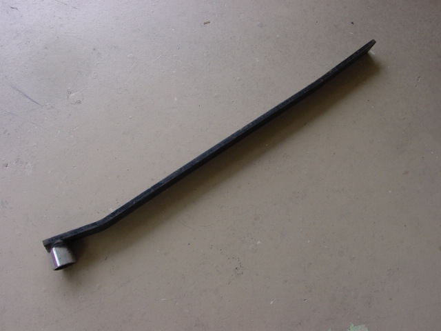

post Oct 24 2009, 05:51 PM
Posts: 355
Joined: 3-March 09
From: Miami, Fl
Member No.: 10,127
Problem solved.....36mm welded onto an iron bar with a slight angle to clear flares.
