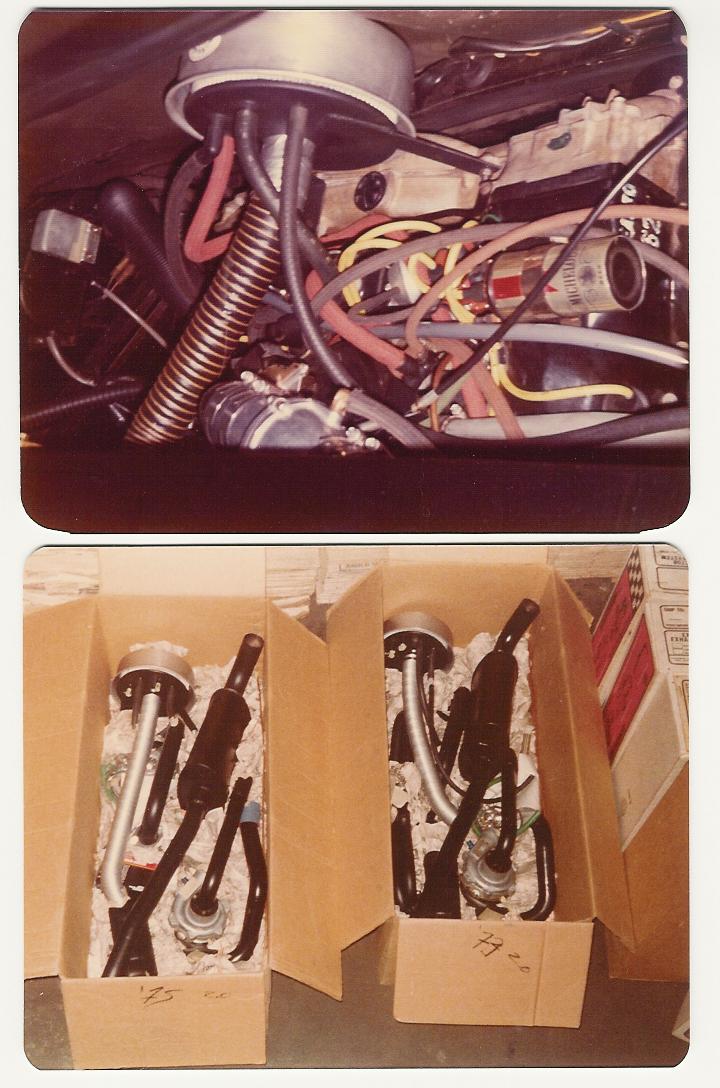

two many cylinders.
The old kit you made for the Djet turbo setup....
I want one.
Rich

Rich, we just couldn't re-introduce THAT kit (IMG:style_emoticons/default/driving.gif)
Marty
