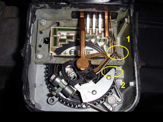

Read here.
jsayre914
post Jan 17 2010, 06:32 PM
Speed Up !!!
Posts: 3,210
Joined: 10-February 08
From: Timonium MD 21093
Member No.: 8,696
thanks for the pic, tell me more about what i am looking at. It looks like an alien space ship control modulator (IMG:style_emoticons/default/blink.gif)
is this what it should look like. or what part is not right. and wich way did you bend it.
sorry (IMG:style_emoticons/default/chair.gif)

QUOTE(jsayre914 @ Jan 17 2010, 04:32 PM) *
That's what's underneath the square black cover on the AFM. The way it look sin the photo is the way it's supposed to be. In my particular case, the contact with the dog-leg on the end was bent so that it occasionally got caught when the flapper opened up. Basically, this shut off the fuel to the injectors when fuel was needed most (e.g. more air coming thru the AFM). So under acceleration, it would bog down and go jerky.
It's worth a quick look under this cover to see how things work while manually pushing the flapper. Other than that, tcheck he usual suspects: vacuum leaks, timing/dwell, dizzy advance. Lots of good advice above.
I also used this site for troubleshooting my L-jet: http://manuals.type4.org/ljet/

First off.. readjust your valves. The Haynes manual has a typo for the valve adjustment specs for the 1.8. They should both be .006. The .008 setting is ONLY for the sodium filled valves that came in the 2.0 heads.
In the picture, the #1 is the fuel pump contact. If you open the AFM flap, that is what turns the pump on. #2 is the wiper contacts that send the air flow information to the computer.
DO NOT ADJUST THE AIR FLOW METER SPRING TENSION!! It is calibrated properly for the engine, and takes a special tool to readjust. Been there, done that. I even own the tool to readjust them. I suggest that you don't open the air flow meter at all.
Check to see if the boot between the air flow meter and the throttle body is cracked. It will cause bucking if it is. Also inspect the harness carefully for broken or cracked wiring.
