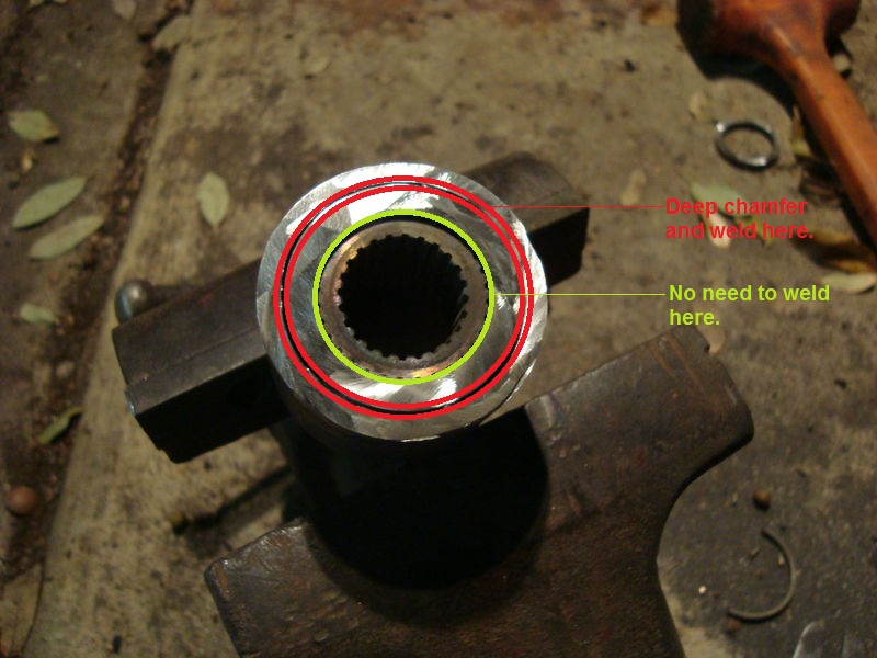

(IMG:http://www.914world.com/bbs2/uploads_offsite/forums.pelicanparts.com-10736-1268020290.8.jpg)
Hey Jamie very nice work. It looks like this may require tig? I'm wondering if this can be done with a mig? It looks to me like the weld on the inner portion would be really tough to get a mig tip in there to do the job.

You could probably use a MIG for the welding. Depending on the torch and gas collar you may have a tough time seeing the bead. It will certainly be a tight fit.
I did use a TIG. I setup the part to rotate such that I could get a fixed angle with the torch head. Then I rotated the part with my left hand. I walked the part rather than the cup.
Make sure you have a stout welder. A 110V will not cut it on this thick steel.

For anyone who might run into the same issues I did, here's how I ended up welding mine...
I only have a 110 mig which works great for everything I've ever needed, but Jamie's right it won't even begin to penetrate this thick hardened steel. I tried even just to tack things in place and the welds popped off like solder.
So I took it to my machinist and described what I wanted, and how I'd seen it done with a TIG. He said there's no way he could get his tig in the front side to get the bead like Jamie did. So he came up with a plan which I think will hold up really well. He cut an aggressive chamfer on the back side between the two main cylinders. Then he welded that chamfer using filler, with lots of penetration. The center spline did not need to be welded because it is geared to the middle cylinder and can't go anywhere. It also gets seized in place because of the heat shrinkage from the weld. And it removes any chance of messing up the spline teeth.
Thanks again Jamie for your excellent write up. For anyone who can't do the great filler-less tig work like you did, this might be the next best option. We'll see how it holds up.

Great idea. It looks like from the picture the inner sleeve can be ground to a chamfer with a bench grinder or belt sander and that alone would be enough for a good recess to fill with filler.
The only thing about the wire feed is the filler is mild steel that is being mixed to the alloy of the sleeve. Non filler welding changes the metallurgy but not as much. This is a twisting force though not a bending force so it is not nearly as critical.
