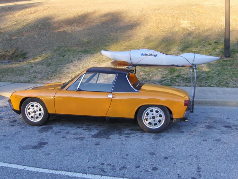

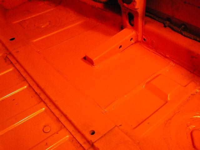

Here are some photos of my trailer hitch, along with some of my kayak carrier. My hobby is whitewater kayaking in the NC and Tn mountains. With this setup, I can enjoy the drive to the rivers as well as the time spent on the rivers.
I made a 1 1/4" tubular hitch receiverfor a trailer hitch. This can hold a trailer ball, a bike rack, or the rig I show to hold up the back of the kayaks. The reciever is supported on the rear by the two bars that I bent up to hug the rear of the car, and go beneath the bumper. These are shown in the photo. The inside of the tube is welded to a 2" by 1/2" inch bar that I heated and bent to follow the underside of the trunk up to the point below the center trunk reinforcement, where I have it bolted through the trunk floor. I cut a notch in the sheet metal heat shield for the muffler to allow this bar to hug the trunk floor. This bar then easily clears a stock muffler, tranny, etc. I notched out the back valence to clear the receiver tube.

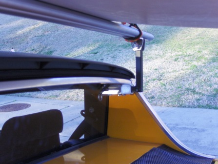

For the front kayak support, I made two aluminum receiver blocks that bolt into the existing tapped holes under the roll bar. These blocks have a notch cut into them that accepts a 3/4 inch square tubular element which is held in place by a simple quick lock 1/4 inch pin. I leave the blocks on all the time. The pins are pulled to allow the crossbar to be simply removed. Works great, carrying up to two kayaks. I was curious to see if the wind from trucks, etc. would cause any problems when I was going down the road at 70 or so. But, no problems. JoeO

Other photos. Note in the rear view that the rear upward tubing members are not symmetrical. I bent the curves using a pair of trees to hold the1" square aluminum tube while I bent them by pushing as hard as I could. I couldn't get the curves to exactly fit, so I made the attachments to fit the uprights. Note that this arrangement allows full access to the trunk and engine compartment while boats are loaded. It also allows removal of the top if desired. JoeO

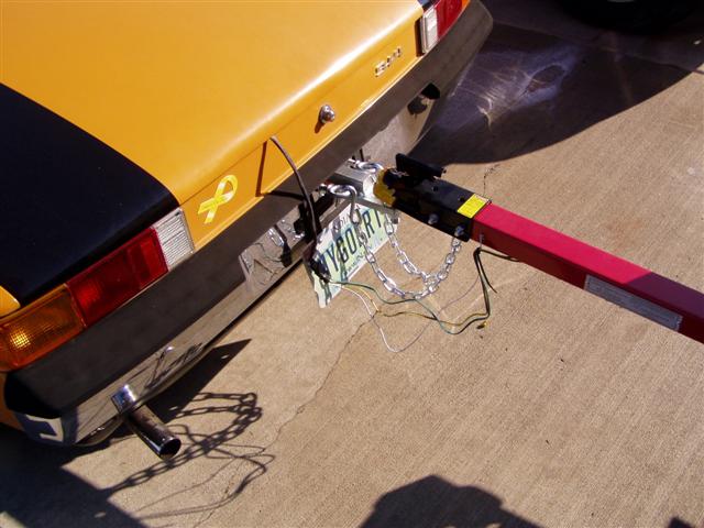

Semi-related....my receiver hitch cover....."show what you tow"

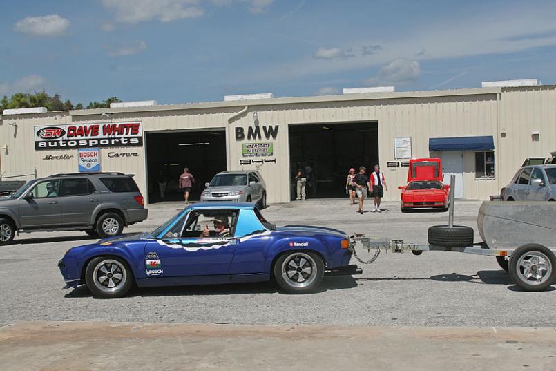

Sorry (IMG:style_emoticons/default/biggrin.gif) (IMG:style_emoticons/default/hijacked.gif) I have a hidden hitch on my 914 behind my rear plate to pull my AX trailer.

I seriously considered doing what Garold did, ie using a tube inside the trunk. I already had made most of the below trunk hardware before I had seen his. The deciding factor was my being able to leave the tag on for quick installs of a hitch bike carrier, etc.
I also seriously considered adding mounts to an old top. I think this would work fine. Years ago I used the foam and rope methods to carry a hang glider.

These pictures are very helpful. I have a slightly different idea though. Most of these hitches seem based on the square tubing protruding through the rear bulkhead that is just behind the bumper, and then going under or inside the trunk.
Has anybody seen a hitch that is on or through the bumper, and is supported with a large bracket/plate behind the bumper that bolts to the bulkhead, instead of going through it. I don't want to cut a big hole in the bulkhead. And I just need a hitch for a very small trailer.
Other ideas?

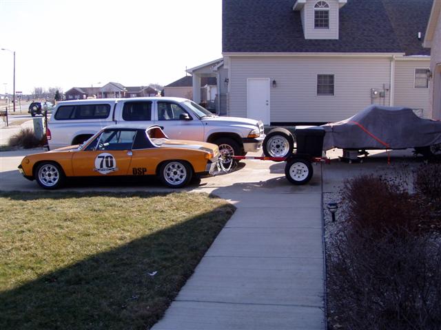

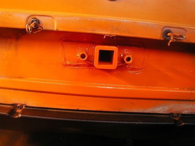

Nope, put a hole in the bulk head for my current build.
Before that I did one that bolted into the bulkhead and came out under the bumper, had a bar that went back t the exhaust hanger on the trans. Don't think I have pictures of it.
Pretty easy you can thread a 1/4" steel behind there, I did not run a rear valance with this setup. Towed great, with my tire trailer.
