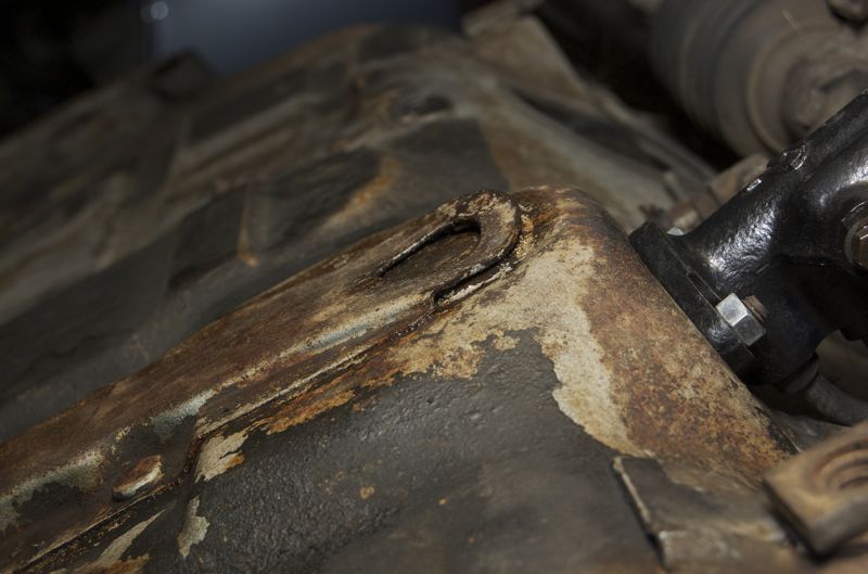

QUOTE(McMark @ Apr 7 2010, 12:07 PM) *
Look around the curve of the brace as the master flexes. The brace is stable and the pan moves. I think I can even see light around it. I could be wrong...

Rick, the factory bracing/box which is under the pedal assembly is open on the forward face. That crack you're seeing is just how it is.

Ya, I know the brace is open. I was looking at the stamped edge. Must be the lighting. Glad it's not cracked. Your brace is working well.

There is one of those U-slits under the pedal cluster. You know, the ones that are all over the floor pan. So there is light coming through there, but it's not rust or cracking. It's just factory holes. (IMG:style_emoticons/default/wacko.gif)

QUOTE(McMark @ Apr 7 2010, 04:11 PM) *
OH! I knew I saw light! That's right! Anywho... Nice brace!

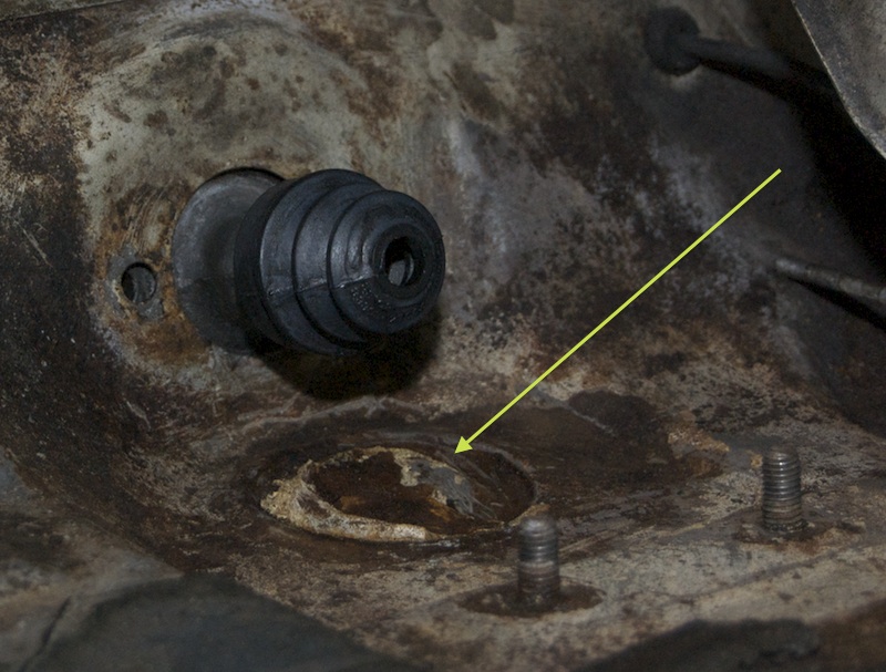

here is the new ones method with lightening holes:
brant
post Apr 7 2010, 07:16 PM
Posts: 12,282
From: Colorado
Member No.: 47
and:
3 Pages V  1 2 3 >
