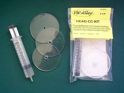

Mark, can I use a buy a head CC kit somewhere? Will a type I kit work or do I have to make my own?
Thank you Mike, Jake, and Mark for your responses.

A head C kit is really complex, I don't know if you want to try to make it yourself.
You need:
* A round piece of plexiglass the same size as the cylinder "register" in the heads. With two holes, one to fill through and one for air to escape.
* A graduated cylinder or pipette from a chemistry supply store.
* Some liquid.
As you see, very complex and difficult to find parts.... (IMG:style_emoticons/default/rolleyes.gif)
--DD

I have a CC kit, you can use it as long as you don't break it (IMG:style_emoticons/default/smile.gif)
I used Castrol Superclean for the liquid...........

Dave's way is being a bit of a TW (IMG:style_emoticons/default/wink.gif)
Just go to a VW bug shop and get a head cc kit for 94mm cylinder. It might not fit perfect but it will work. About $20.
Put a smear of grease on the outer edge of the plate to make the seal, then just use water in the syringe that comes with the kit. When you clean up just make sure to blow out the water.

no need to have a round piece.......you can place the plexiglass on the surface of the head and subtract the volume from bottom of head to the mating surface. (cylinder)

Depending on deck height and chamber volumn you are looking at between 8.9-9.75:1. On engines with as big a bore as ours 1cc doesn't make that big of a difference, about a .10 of a point. Hit the site:
http://www.rbracing-rsr.com/compstaticcalc.html
The deck hieght will make a difference as well. If you want to measure your chamber volumn go to the vet and get the biggest syringe they have, take the needle out and get a piece of plexiglas to seal the top of the chamber. Fill the chamber and measure the amount from the ccs on the side of the syringe.

QUOTE(jkeyzer @ Apr 5 2004, 12:45 PM)
Mike, why superclean?
Low surface tension so you don't have a big bulge of water at the exit hole.. At the very least put some detergent in the water if you use that. Soap breaks surface tension.

You can get a kit here:
http://www.vwalley.com/
