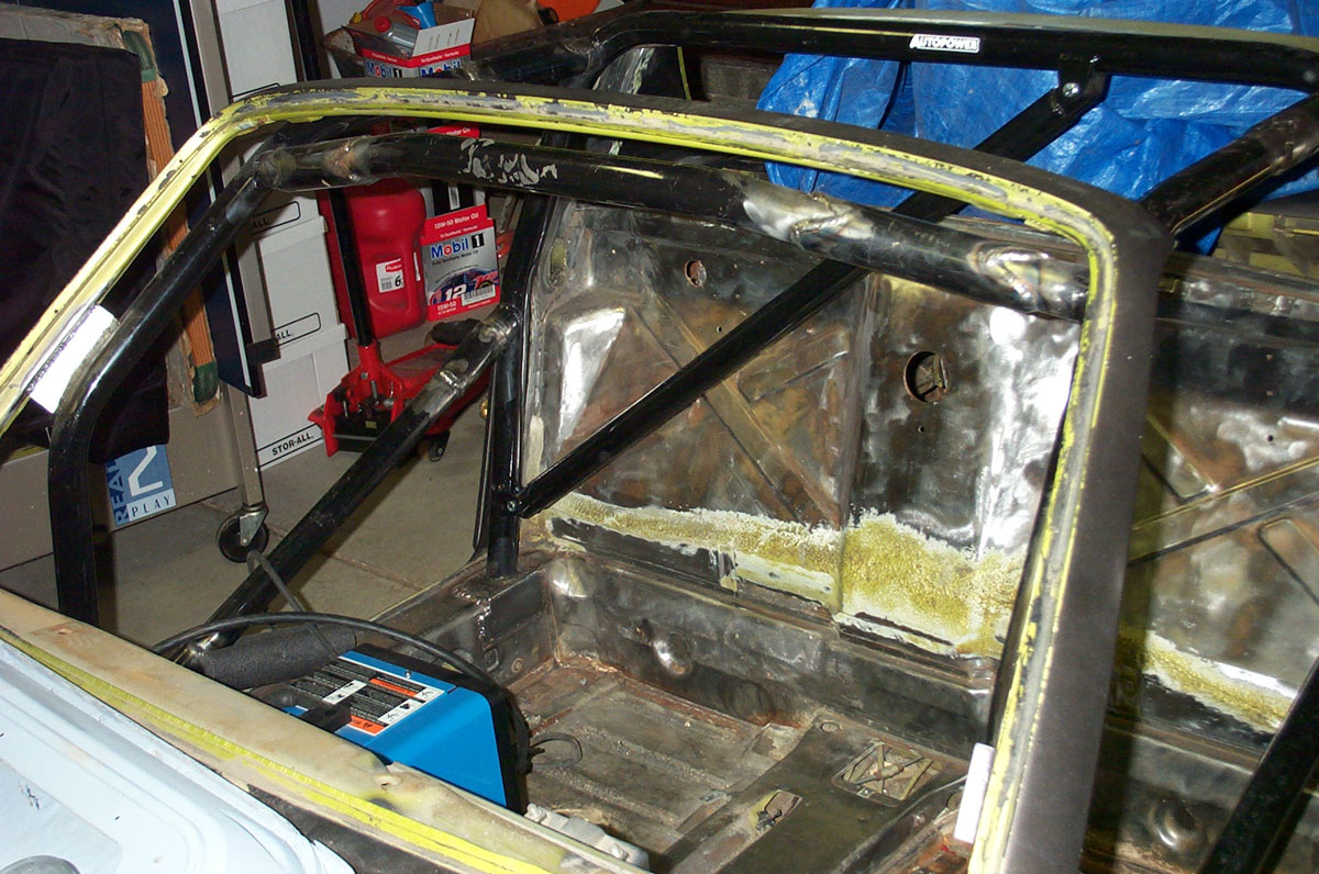

Me either until I bought mine. Check out this thread. My first real welding project
