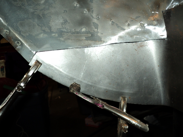

Spy shots from inside Area51Werks. Lots of cutting, hammering, fabrication and welding were rumored to have taken place today.

One moreAttached Image

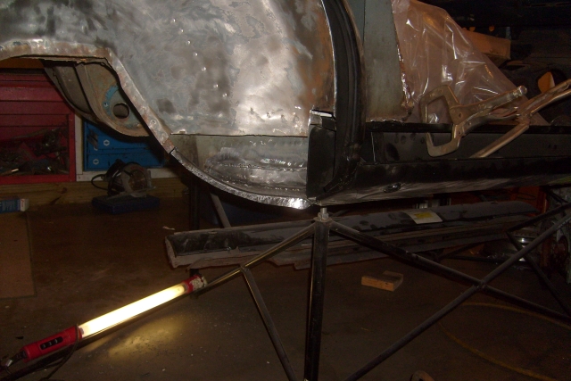

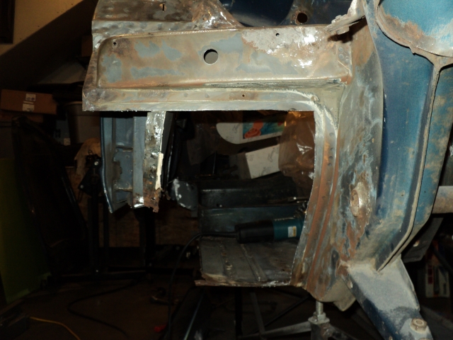

More welding photos from last weekend

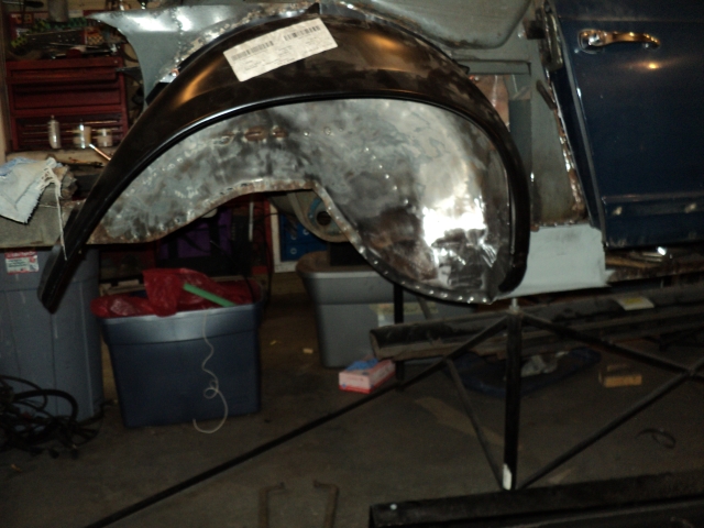

Couple more
Scary! (IMG:style_emoticons/default/unsure.gif)

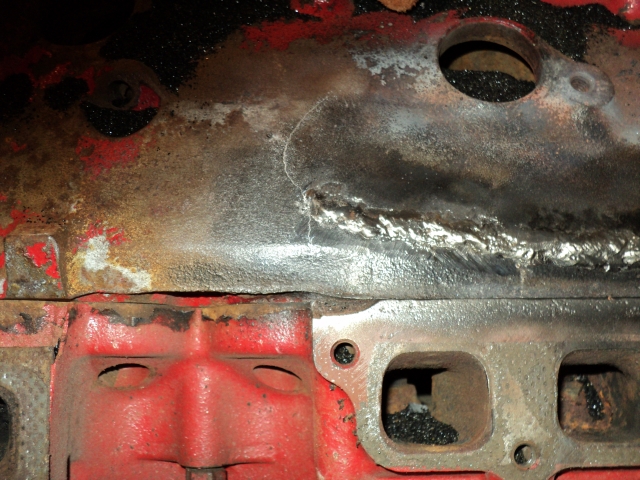

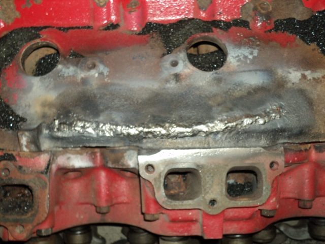

So I have this 29 Ford Rat Rod body in my storage garage. It was a coupe but the roof went missing many years ago. My oldest son Aric took an interest in it so I started scrounging for parts. I came across a 348 engine a friend had rebuilt but never used. He told me I could have it if I can an picked it up. Well it was laying out back of his garage wrapped in plastic. It's almost junk. I pulled it apart and the internals are ok. the heads will need to completely gone through.
Then I discovered this... (IMG:style_emoticons/default/WTF.gif)

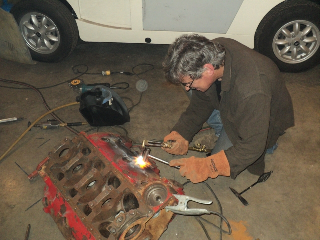

So Aric and I tag teamed it. I pulled out the buzz box and some nickel welding rod. Aric heated the block with the rose bud torch head and kept it hot while I arc welded the crack. We had the head bolted on tight and worked the crack slow. After welding you will have some pin holes. The sand cast block has lots of impurity's. I took the cutting head, (couldn't find my #2 tip) and melted the nickel rod around the pin holes and peened them closed.
rick 918-S
post Jul 29 2010, 10:14 PM
Hey nice rack! -Celette
Posts: 21,239
From: Now in Superior WI
Member No.: 43

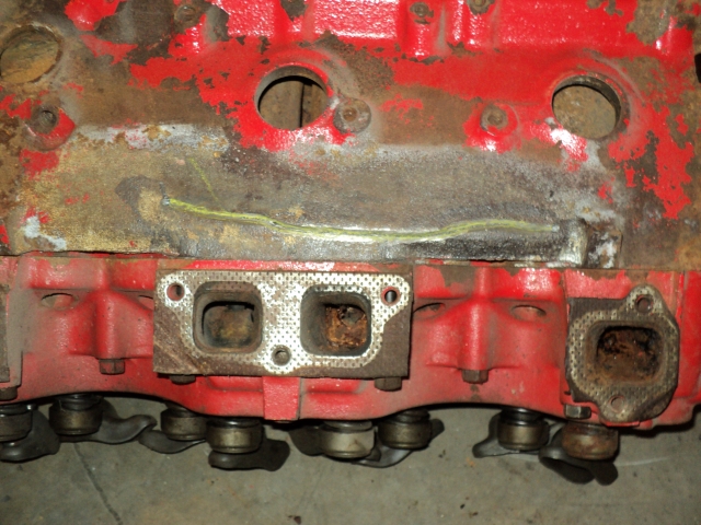

And here it is. We filled the block with coal slag to help the block cool slow and covered it with blankets.
BTW: This is a common problem on these early blocks. The water jacket at the top of the block is very thin. Many of these blocks get tossed but with a little patience they can be welded.

Well, We had a small set back. I ran low on Acetylene about 2/3 of the way through the welding so we cut the heat off kind of early. I thought I was ok but as with any cast iron you never really know until you check on things the next day. So, off to the welding supply store and back at the welding. More later.
