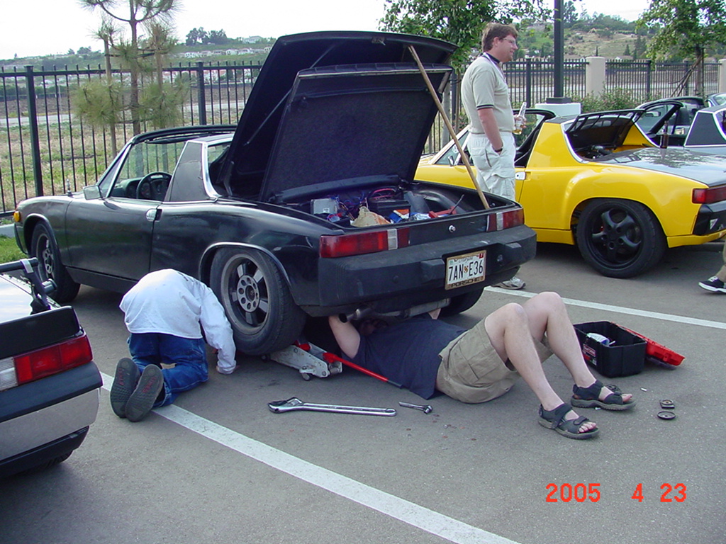

who was the suby guy from Maryland? he drove it out to CA the day after he got it running for the WCC 05. he won a set of WEVO trans mounts and installed them in teh parking lot 10 minutes after winning them
sean_v8_914
post Aug 6 2010, 02:41 AM
Chingon 601
Posts: 4,011
Joined: 1-February 05
From: San Diego
Member No.: 3,541
here he is
