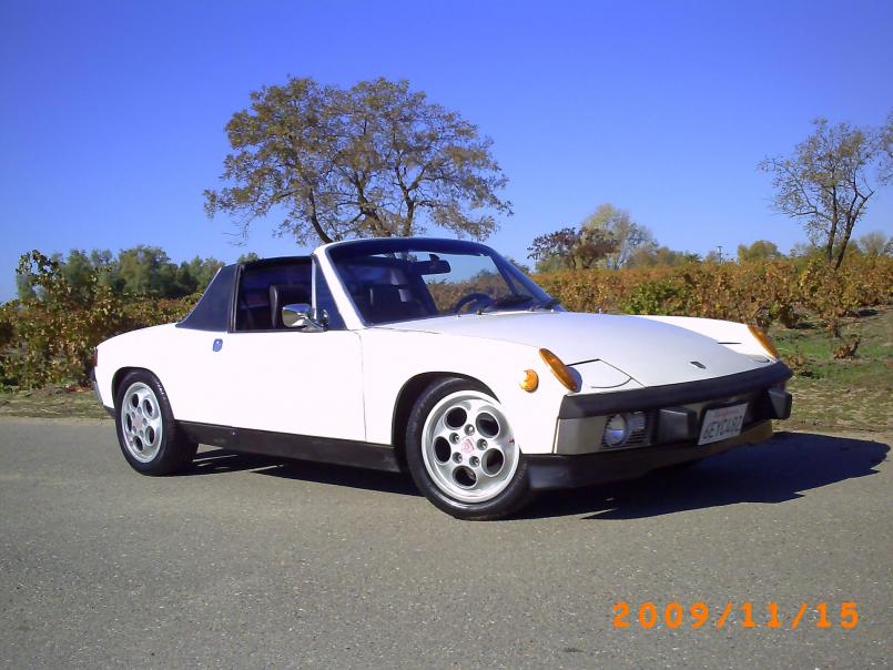

campbellcj
post Aug 7 2010, 09:46 AM
I can't Re Member
Posts: 4,705
Joined: 26-December 02
From: Agoura, CA
Member No.: 21
Bit of an older pic but these are 16x7's with Hoosier 205/45R16's. Max negative camber and fender lips pulled n' rolled. Previously I used 15x7 cookies with 205/50's and they fit fine.

QUOTE(campbellcj @ Aug 7 2010, 07:46 AM) *
(IMG:http://www.914world.com/bbs2/uploads_offsite/farm1.static.flickr.com-21-1281196004.1.jpg)
This is where I am heading (IMG:style_emoticons/default/aktion035.gif)
