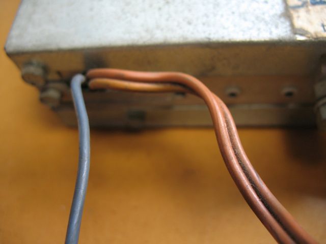

My 1974 came with a junkie Kenwood CD player that skips over every bump. I have a radio that came out of a 1975 914 but need advice please on installation. The Kenwood has a proprietary plug connected to a bunch of wires, maybe 7 or 8. I suspect the original Porsche wiring is cut to fit into the special plug that goes into the back of this monstrosity.
In looking at the original Blaupunkt radio, I only see 4 wires and a hole for the antenna connector. Wouldn't each speaker need two wires (total 4), a 12V hot wire and a ground for a minimum of 6? What's with the special plug coming out of the radio: is it only one of two speaker connectors (like the other one is missing?).

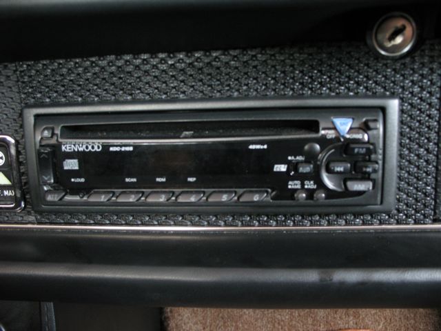

The Kenwood.

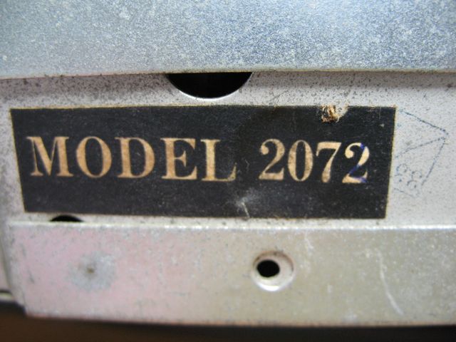

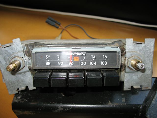

The Blaupunkt.

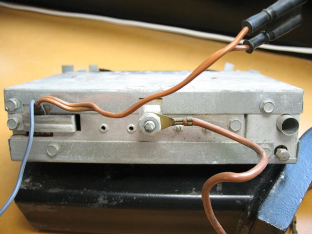

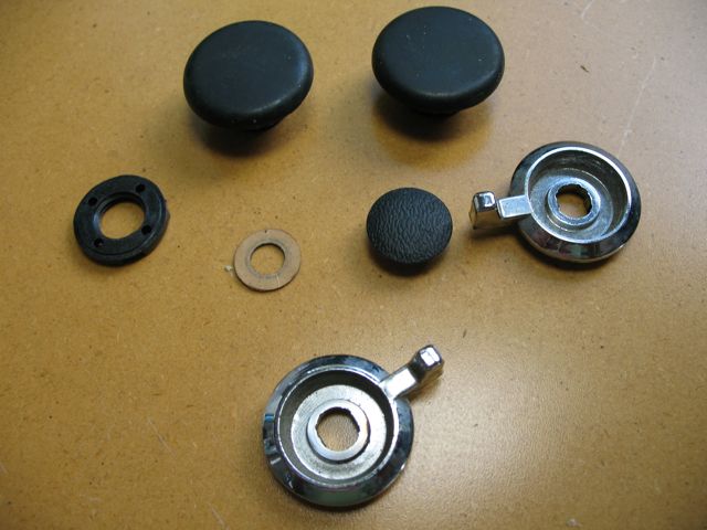

More...

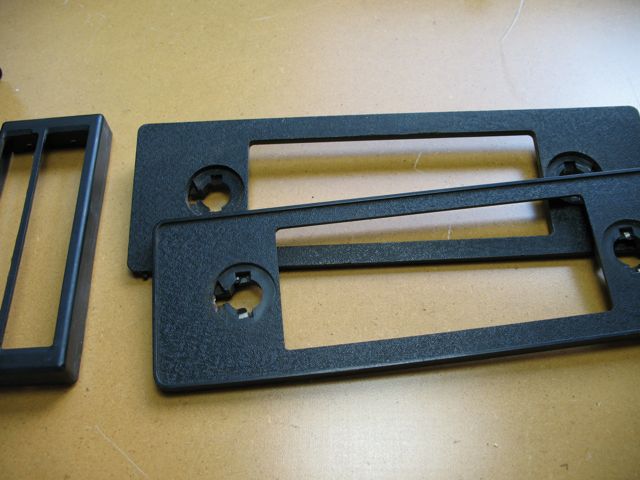

Finally,
Two faceplates. Think I like the "in dash" look but my current dashboard piece has the big square hole in it.

Concerning the speakers, it just looks like 2 brown wires, connected to each other, splay into that funky connector. Shouldn't the radio have 4 wires to connect the speakers? Shouldn't there be 6 wires coming out of the back? I only have 4...

That radio was made before the switch to floating speaker grounds. The speaker negative could be the vehicle chassis unless it is a mono unit. It it is mono, there is only a single speaker channel and your funky connector could be both positive and negative speaker leads.

Then it's gotta be mono. I'm SURE it would say "Stereo" on it otherwise, no? Shouldn't be any harm in splitting the signal from that dual connector then, one positive and one negative wire sent to each speaker then.

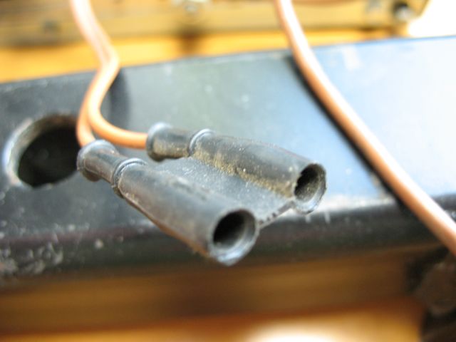

Could this be the connector? This would indicate that the radio is in fact mono...
Speaker Connector
Paul

If it is mono, you will damage it if you wire the speakers in paralelle. You need to wire them in series. For a series circuit, Left speaker positive to radio. Left speaker negative to Right speaker positive. Right speaker negative to radio. This will double the speaker impeedance and protect the amplifier circuit. If they are wired in paralelle, it will half the load and burn out the radio.

I would not waste money on that connector. A standard crimp bullet is all you need. That connector is called a "banana" and is mostly used in home Hi-Fi.

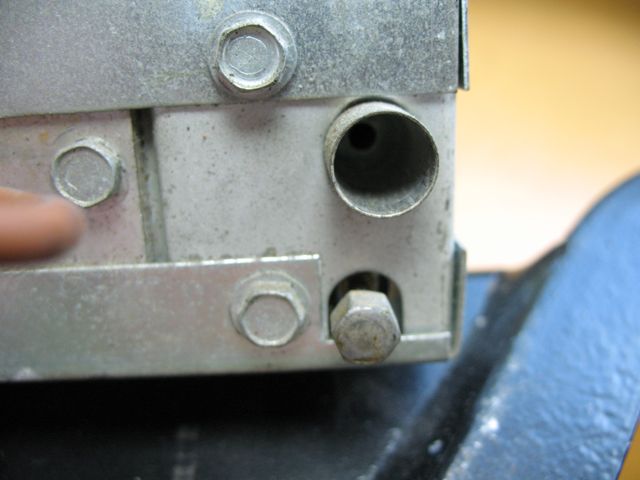

Mono. Best to wire speakers in series. What's the knob on the back in the lower right corner? Antenna trim? Bench test the thing before you install it. You might want to clean the volume pot (TV tuner cleaner sprayed inside pot).

I don't really know. It's right under the antenna plug, a trim would somehow help with tuning?
Anyway, since the radio came out of a 914 I thought a lot of people would have said AHA!!! This is the same radio I have! THIS is how to hook it up, etc. Seems like there must be a bunch of different radios installed.
I got it from Brad Mayeur. Maybe he didn't include the potentiometer connector thingy. I'll post on my progress as things develop...
