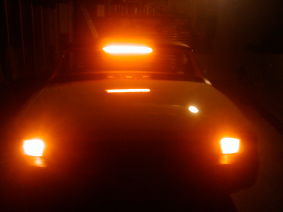

got a 3rd brake light bar from a 993. The curvature is almost exactly that of the underside of the targa bar. Ran the wires thru the trim down the left side and back to the left tail light for ground and brake light signal.
not too bad for about an hour... (IMG:style_emoticons/default/biggrin.gif)

post Aug 12 2010, 10:13 PM
Going back to the Dark Side!
Posts: 4,300
Joined: 4-October 04
From: Auburn, CA
Member No.: 2,880
wow, just went out and tried it in the dark......that should get their attention from behind. (IMG:style_emoticons/default/biggrin.gif)

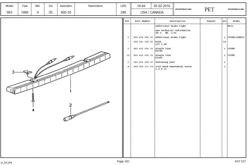

narino
post Aug 13 2010, 02:08 PM
Posts: 234
Joined: 14-August 07
From: Los Angeles, CA
Member No.: 8,001
I think this is the part number if others are looking for it.
993 631 060 00
Though it was almost $300 bucks on PP. yikes! If someone finds a cheap source please chime in.
