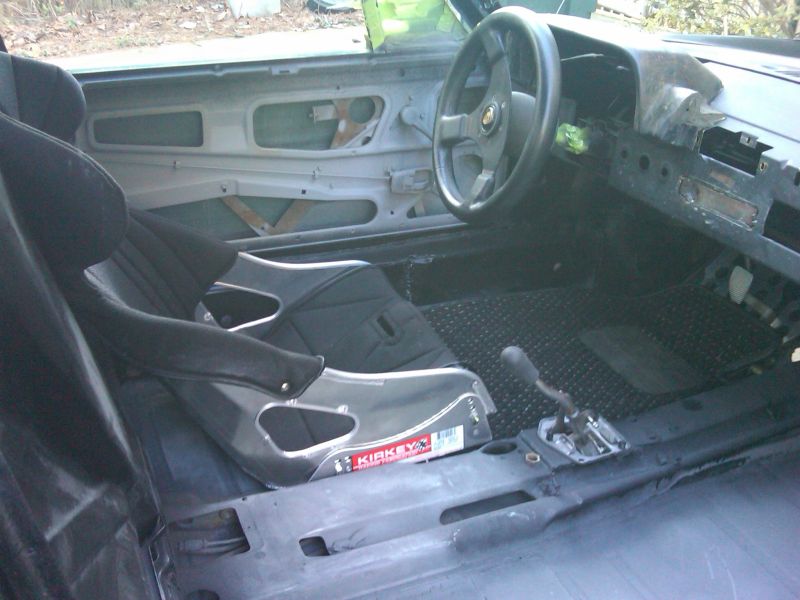

What shifter is that in the cockpit?
BTW, how do you like those seats?
Andys
BIGKAT_83
post Sep 9 2010, 09:59 AM
Posts: 1,800
Joined: 25-January 03
From: Way down south Bogart,GA
Member No.: 194
QUOTE(andys @ Sep 9 2010, 11:40 AM) *
Hey Bob, nice work. Looks like a stock factory install!
Andys
Thanks Andy. The shifter is from a mids 90's Toyota Corolla. I got the Idea from you with a link to the GT40 sites.
The seats are really tight for a 38" wasit guy like me.
Now to get back to work on my LS1 car.
Bob

Is that a cable shift? Care to share how your linkage is setup?
Really looks like a well done car! No GRM20xx there! (And there is proof of previous v8 in the firewall dent!)
BIGKAT_83
post Sep 9 2010, 10:22 AM
Posts: 1,800
Member No.: 194
Cable shifter for sure. I don't have any pictures of my linkage handy. I'll get some up the next time I'm home.
I really think the transaxle is the best part of the whole car. It shifts just like a new import car. The gearing matches the engine with a useable first gear and gives the car a complete different feeling.
Now I'm thinking audi/boxster transaxle for my LS1 car.
Found a pix
Bob

Very nice looking shifter setup! Did you buy or make it? Cost?
Also it looks like you still have the tailpiece on the trani, you converted that to FWD after the pic, right? Or is it running like that?
BIGKAT_83
post Sep 9 2010, 11:34 AM
Posts: 1,800
Member No.: 194
QUOTE(Andyrew @ Sep 9 2010, 01:09 PM) *
Andrew I built the set up myself. The shifter is a $10 part from the pick n pull. The cables and joints are what cost the money. I think they were about $150
The picture is before I removed the rear diff.
Bob (IMG:style_emoticons/default/driving.gif)

Nicely done! Where did you get the cables and joints if you dont mind me asking? I'll need to get some for my Audi conversion regardless if I go automatic or manual.
Toyota corolla shifter works eh? Gotta remember that the next time I scrounge for some honda parts.
[/quote]
The toyo corolla, mr2 and a honda accord (90ish) all work... I have the honda part.
The cables bob got are bullet proof and $$$, for mine we are going to try summit cables.. A little lighter and cheaper..
The corolla part needs to have a reverse-er mechinism built in.. Bob did this with some added flexability thrown in for length of throw..
Wait until you see his dash and such.. more goodies to see....
andys
post Sep 9 2010, 03:52 PM
Posts: 2,165
Joined: 21-May 03
From: Valencia, CA
Member No.: 721
The MR2 shifter works out well because the cable bulkheads point to the rear; the Corolla/Celica stuff points forward though they can be turned around. Another shifter to add to the list is from an 80's-90's Mitsubishi. Whatever shifter you use, it may require translation to get the right direction of movement. I buy my cables from Control Cables, Inc. (Tuthill distributor) in SoCal. They'll make up any cable length, any end, any bulkhead all by phone and a credit card. McMaster-Carr can do it too, but it takes longer and they can't give you any technical advice.
