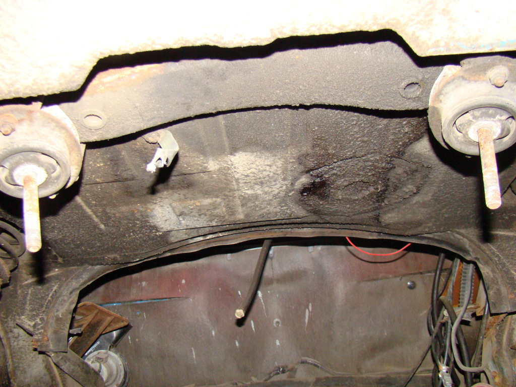

Under the back half...
(IMG:http://www.914world.com/bbs2/uploads_offsite/i163.photobucket.com-12156-1286502737.2.jpg)

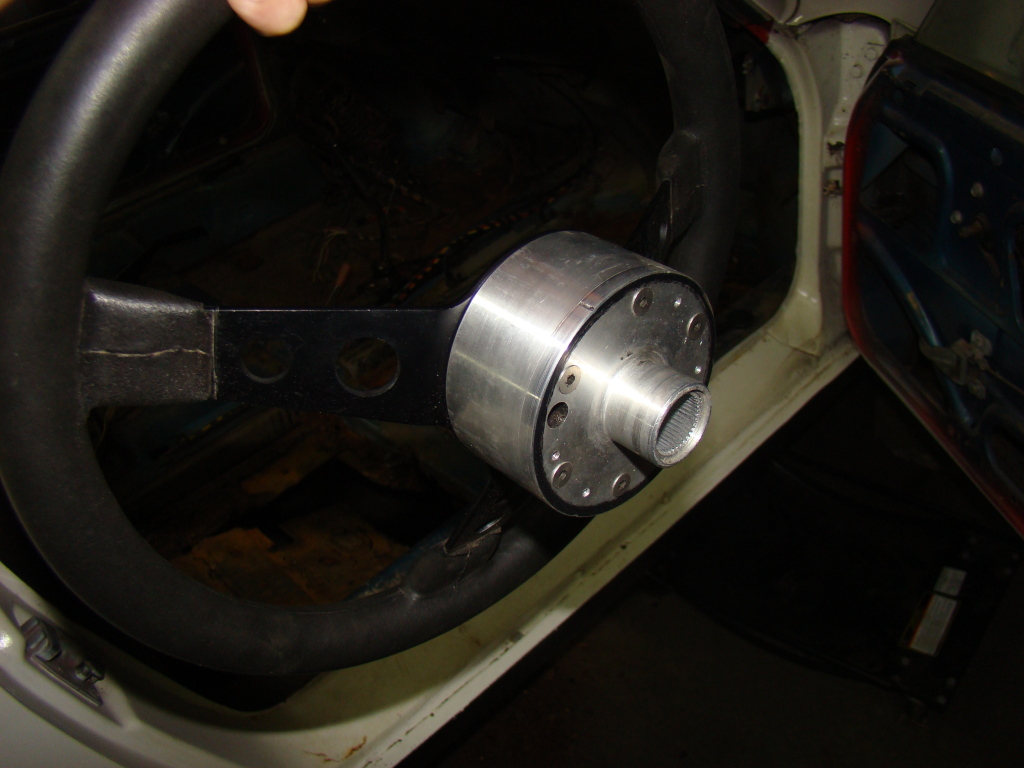

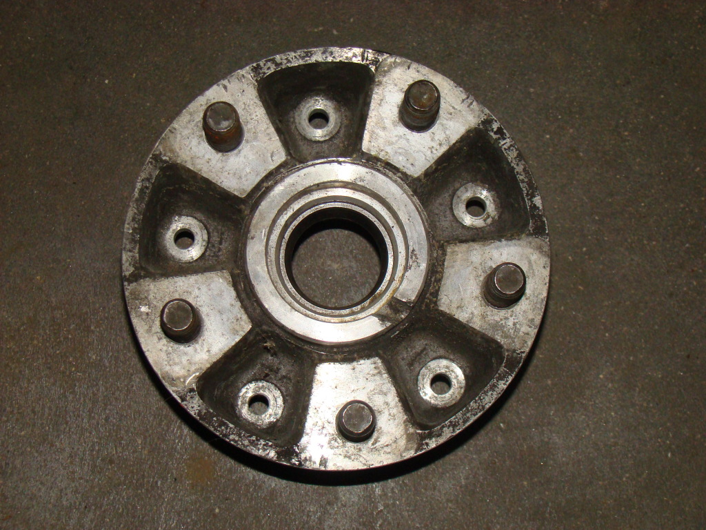

The hub I made for my MOMO wheel out of the stock set up and a machined adapter... I am thinking about making these along with instructions how to DIY.... That way you can have optimum wheel clearance and style for cheaper than the MOMO adapters.
(IMG:http://www.914world.com/bbs2/uploads_offsite/i163.photobucket.com-12156-1286502737.3.jpg)

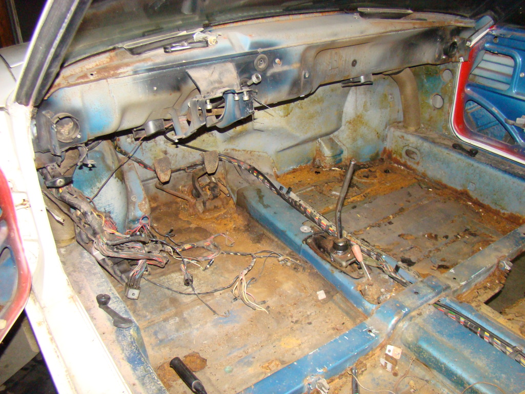

Interior is peeled out... Getting ready for a tubular set of Long supports removing the seat braces with a lower replacement and harness bar comming soon.... Along with replacement floor pans and some HELL hole work...
(IMG:http://www.914world.com/bbs2/uploads_offsite/i163.photobucket.com-12156-1286502737.7.jpg)

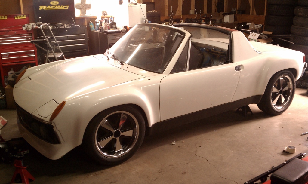

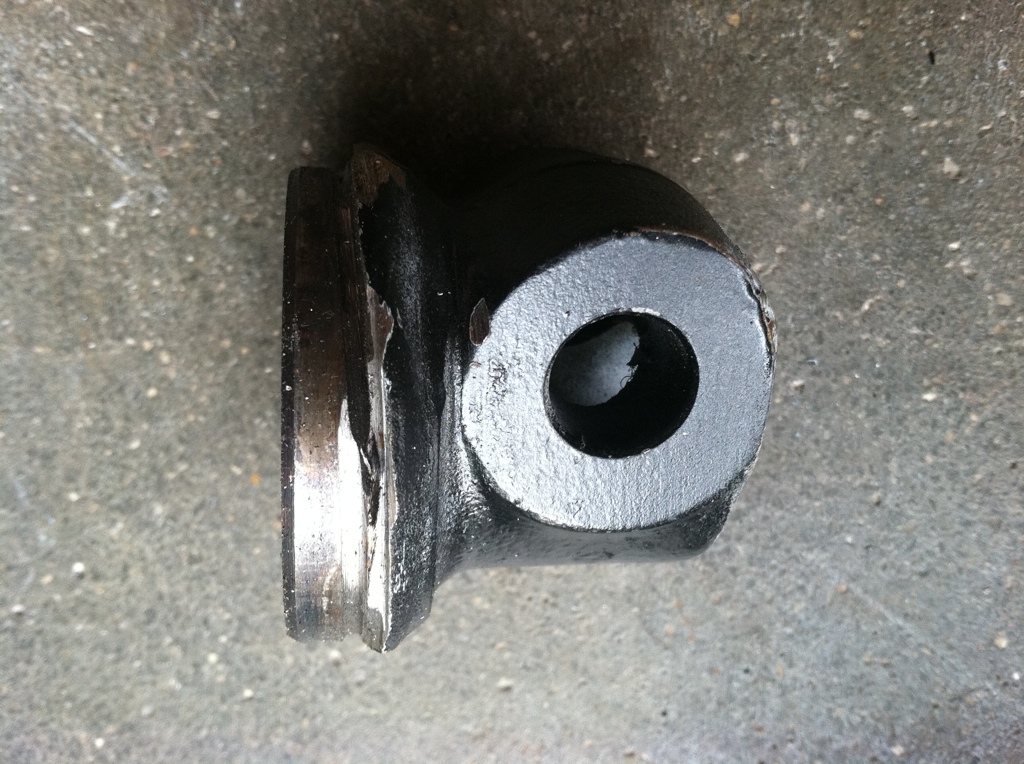

So it has been entirely way too long since my last update but I have been up to some things lately and I will try to catch you up as much as I can....

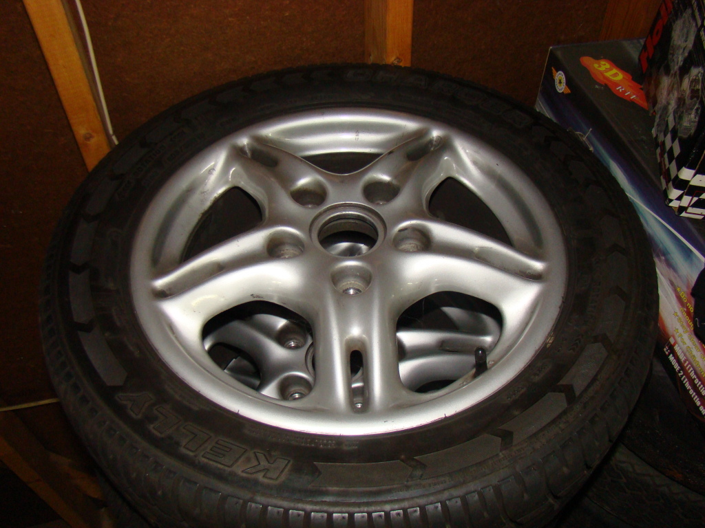

So I bought some wheels for the car back in February, I put my suspension back on for a day or two so I could mount them and see how they look.
(IMG:http://www.914world.com/bbs2/uploads_offsite/i163.photobucket.com-12156-1305158417.1.jpg)
I like them! Cant wait to see it all the way down with the engine in.
Then after the suspension came back off I started with the modification of the front struts. Talking with a friend he had recently modified his Koni fronts to raise the spindles and lower the car. That way the car is not lowered by the torsion bars and the suspension is closer to it's original geometry. So I have BOGEs and thought, Why not....

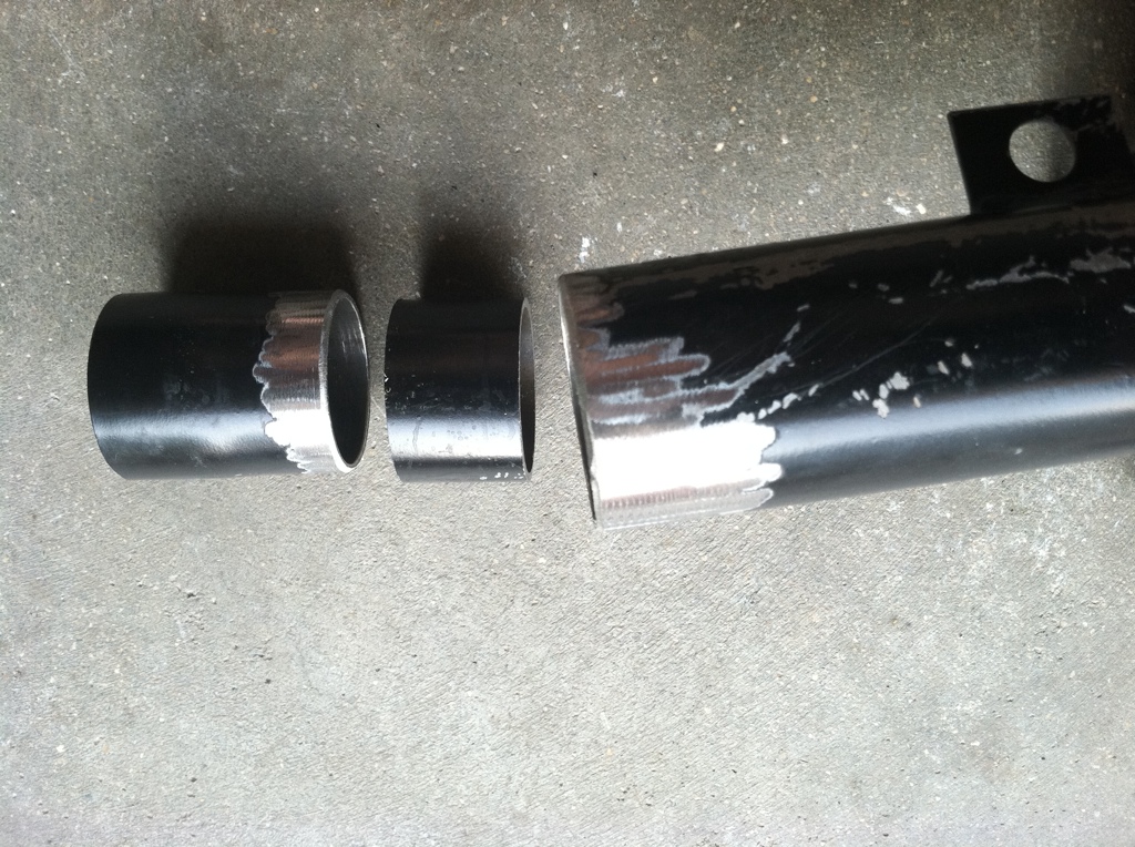

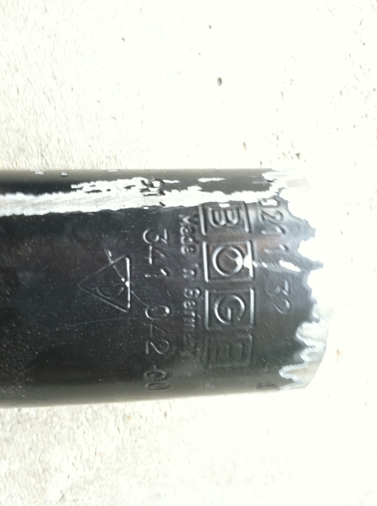

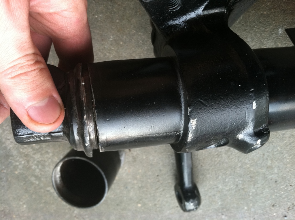

Because Boges are not made the same way as Koni's I had to take a different route. I started by removing the bottom Mount.
(IMG:http://www.914world.com/bbs2/uploads_offsite/i163.photobucket.com-12156-1305158417.2.jpg)
(IMG:http://www.914world.com/bbs2/uploads_offsite/i163.photobucket.com-12156-1305158417.3.jpg)
And then I cut 1.5" out of the top section just above the BOGE logo... (IMG:style_emoticons/default/sawzall-smiley.gif)
(IMG:http://www.914world.com/bbs2/uploads_offsite/i163.photobucket.com-12156-1305158417.4.jpg)
(IMG:http://www.914world.com/bbs2/uploads_offsite/i163.photobucket.com-12156-1305158417.5.jpg)

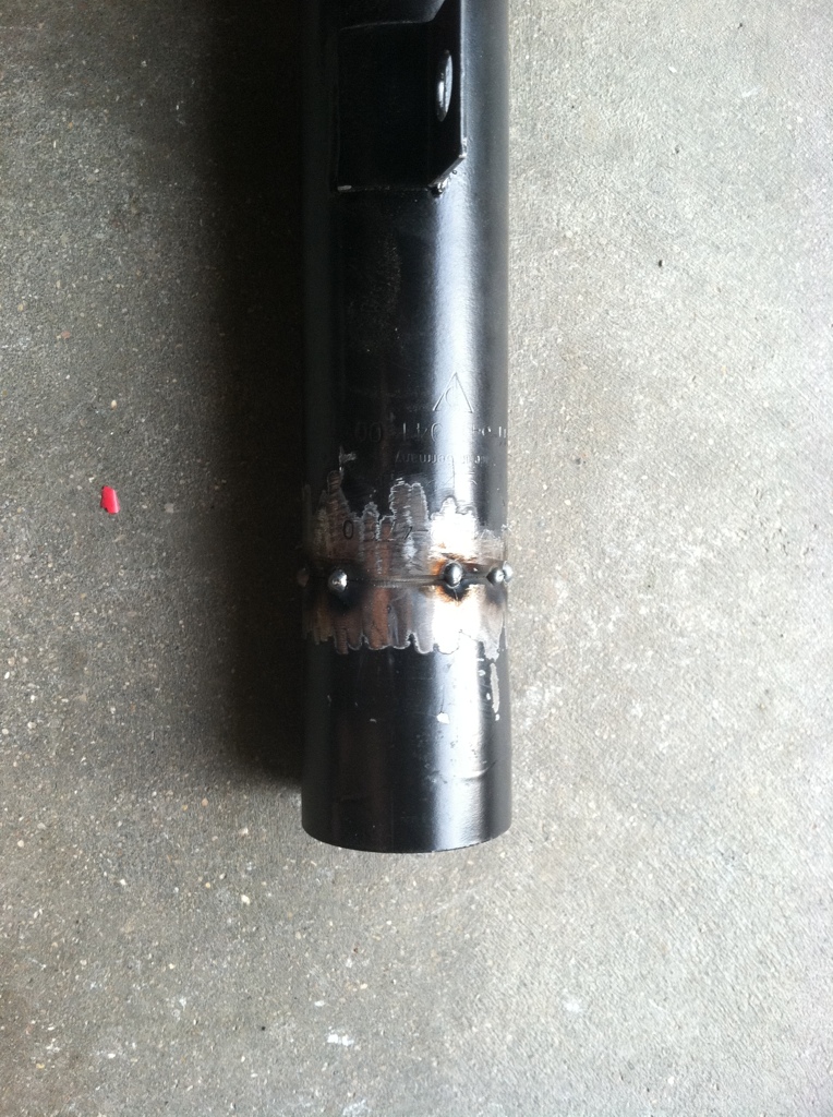

Then I tack welded the threaded piece of the tube back on the strut itself.
(IMG:http://www.914world.com/bbs2/uploads_offsite/i163.photobucket.com-12156-1305158418.6.jpg)
Tomorrow I plan on stopping by my dads shop to turn down a piece of 4140 to add an 1.5" to the bottom and weld the Ball joint mount to it. (IMG:style_emoticons/default/welder.gif)
I would like to get back with my engine as well... I am just playing the sit around and wait game with my Heads...... I hope they make it back from CA. (IMG:style_emoticons/default/headbang.gif)
As it has been the longest winter in Ohio that I can remember... Now that it is seeming to get warmer, I can get back out in the garage more to work... So I will post more as the weather improves.
