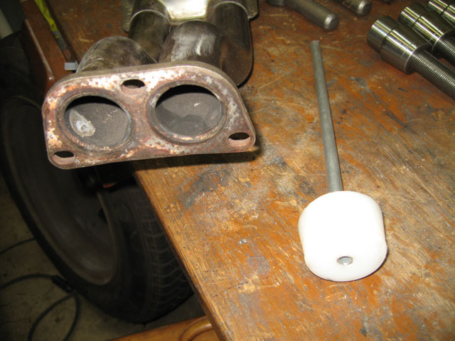

The hardest part is putting the heaterbox back up and keeping the copper gaskets in place. The pushrod tubes will try to knock them off. I've used copper silicone, but you have to wait until it dries.
Then there is making sure they actually are sealed. This is what I use for that
(IMG:http://www.914world.com/bbs2/uploads_offsite/www.914club.com-11782-1287197301.1.jpg)
