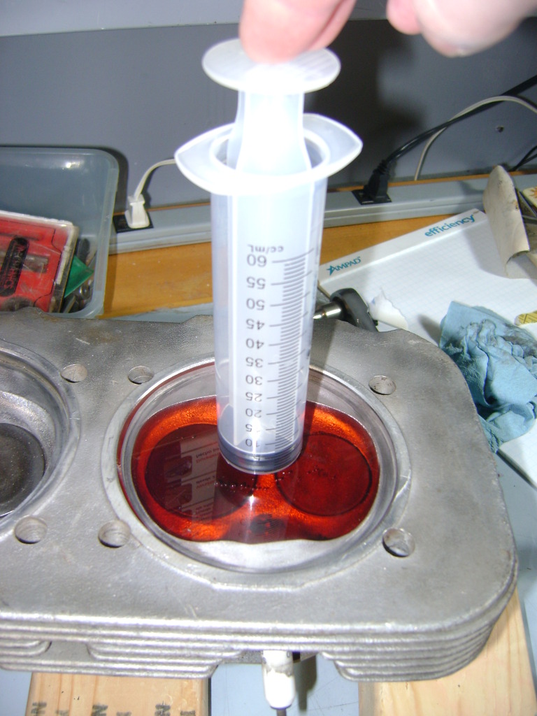

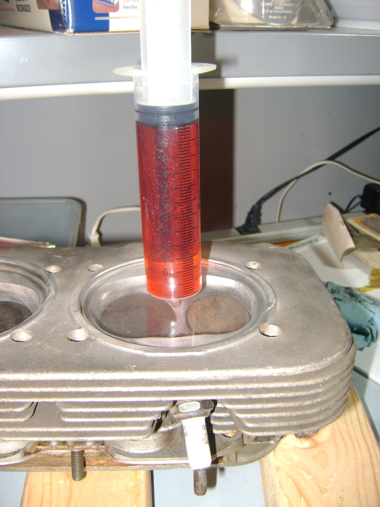

3 - What compression ratio should I target? I am working that step right now - CC'ing the heads & setting the deck height.

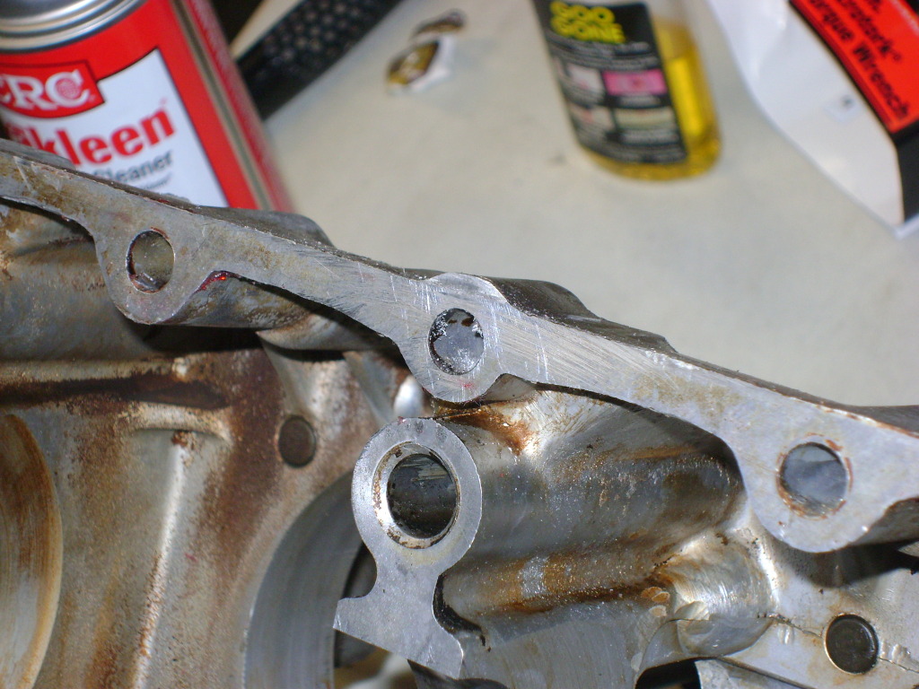

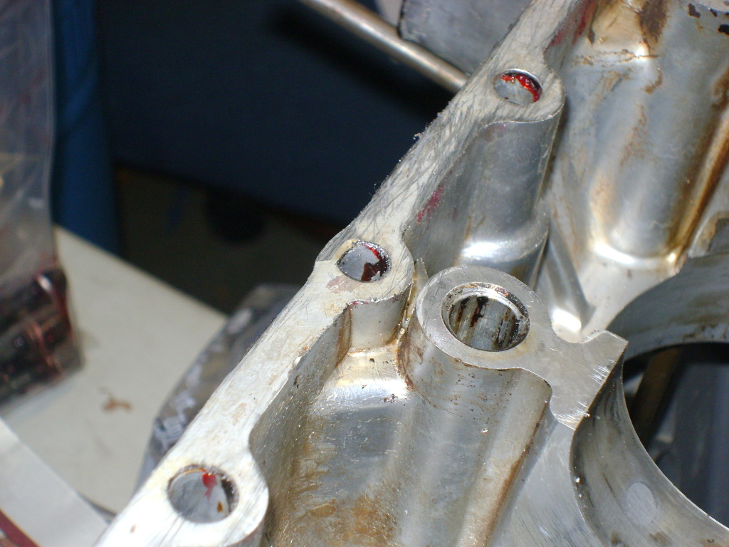

5 - After splitting the case, there were 2 or 3 "bumps" that needed a little "flattening out" with a file. Can the case be damaged by trying to clean up the nasty spots, or is there a way for me to make sure to get it right?
I imagine that the only thing I could do would be to remove all the studs and rub each side over some sandpaper taped down to a very flat surface...

3. Well, good question. If they are stock 2.0l heads, it seems that 8.6 to 1 is about as high as you'd want to go for a stock motor, but I'd say this is all part of what else you are doing with the motor. If it is a stock class, they might dictate CR.

5. what are these 2-3 bumps? if they are in the sealing surface, you might want to look for a new case. Have the case checked by a machinist show for sunken registers and flat surfaces.
Yes, a case is very likely to be ruined by using a file on it, practically anywhere but on the outside. (IMG:style_emoticons/default/headbang.gif)
You cannot just flatten out a whole case side as that would make the main bearing journals out of round and sure, ALL can be fixed, but it would be cheaper to find a good case.

3 - Based on my measurements, I am at about 8.2 right now. This motor has concave pistons. To up the CR, I would need to reduce the head volume or get domed pistons, right? How much does it cost to have the heads flycut for a lower volume combustion chamber? They read 60ccs now.

5 - The worst bump was on both sides and at the very top. I didnt goe nuts with the file. I just kept it perfectly flat on the case halves and took off any high spots.
FILE??!? Find yourself someone with a granite surface plate who knows how to use it. Plan on needing a line bore after and maybe you won't actually need it.

"FILE??!? Find yourself someone with a granite surface plate who knows how to use it."
Everyone is jumping to the conclusion that I filed the surface of the case I did NOT. I just used the file as a straight edge and went around checking the flatness. There WERE a couple of burrs and I did not go crazy or alter the flatness. AND I have a granite surface plate at work.

I asked the question if I could "clean up" the edge by taping sandpaper down to a flat surface.
Cool. Again - lots of people have no clue. If your surface is _really_ flat (which yours should be) and you can assure that both halves get exactly identical pressure everywhere and can verify that the crankshaft centerline and camshaft bores are still round and centered, you should be in great shape.

Two pics of the "bumps" on the case. These two areas are the ONLY place I had to actually "file" and they are on the very topmost part of the case.
(IMG:http://www.914world.com/bbs2/uploads_offsite/i366.photobucket.com-10819-1287579768.1.jpg)
(IMG:http://www.914world.com/bbs2/uploads_offsite/i366.photobucket.com-10819-1287579769.2.jpg)
Here are two pics of me cc-ing the head:
before
(IMG:http://www.914world.com/bbs2/uploads_offsite/i366.photobucket.com-10819-1287579770.3.jpg)
after
(IMG:http://www.914world.com/bbs2/uploads_offsite/i366.photobucket.com-10819-1287579771.4.jpg)
does 60ccs sound correct for a stock 2.0 head?
Stu
Jake Raby
post Oct 20 2010, 07:45 AM
Engine Surgeon
Posts: 9,398
Joined: 31-August 03
From: Lost
Member No.: 1,095
Get rid of those sodium filled exhaust valves!! BOOM!
Most 2.0 914 heads are 57-58cc if they haven't been flycut
