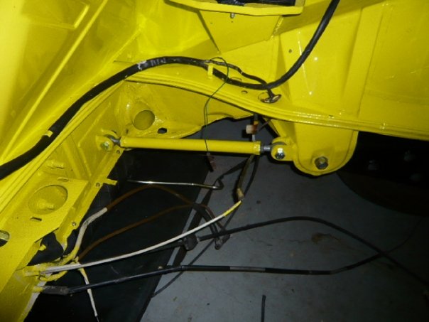

Brant has a brace similar to this one:
(IMG:http://www.914world.com/bbs2/uploads_offsite/sphotos.ak.fbcdn.net-1110-1290381261.1.jpg)
Chris has those too.

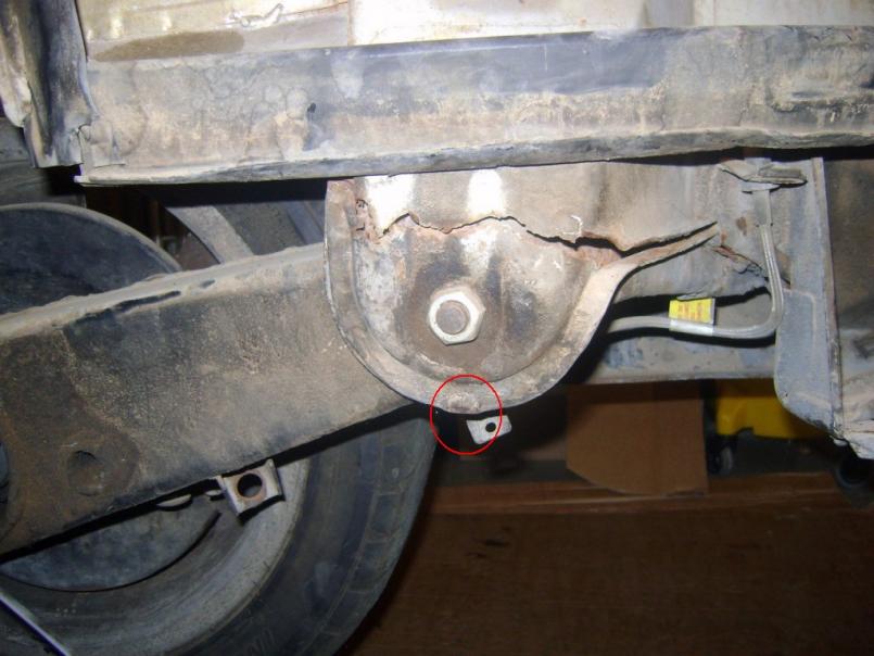

Just a heads up on prevenative maintenance. There are many stamped drains located throughout the body sheetmetal. Be sure the one circled in red is clear or the the mount will rust from the inside out
