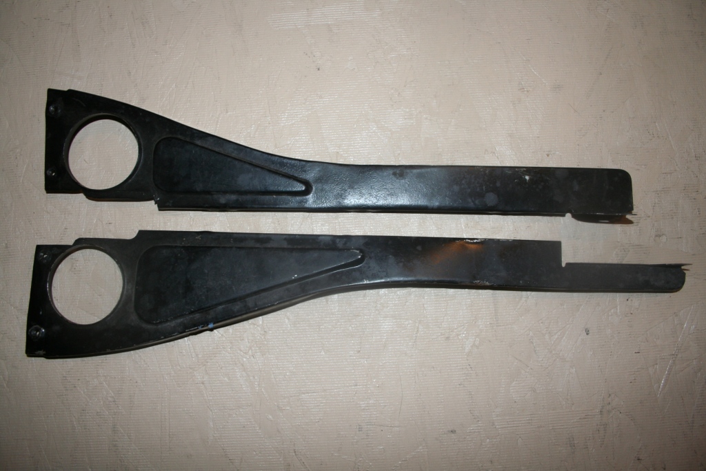

I have some stock 6 side pieces. I'll take some pics and measure. I also bought the backdated heater ducts. Guys on pelican suggest using a hammer on the metal duct to make clearance around the distributor if you need it.
not my engine in pics

post Jan 8 2011, 08:51 PM
914-6 GT in waiting
Posts: 20,534
Joined: 19-September 09
Member No.: 10,825
pic
post Jan 8 2011, 08:53 PM
914-6 GT in waiting
Posts: 20,534
Member No.: 10,825
hole is 2 5/8. I'm guessing hose is about 2 1/2?

Member No.: 10,825
heater backdate tin. paid $110 on pelican classified. They also sell repro pieces.

post Jan 12 2011, 11:34 AM
914-6 GT in waiting
Posts: 20,534
Member No.: 10,825
QUOTE(mepstein @ Jan 8 2011, 10:26 PM) *
I did a trial fit on the engine. Piece on the left needs some clearancing around the alternator. Piece on the right needs some material ground off on the flange on the elbow to clearance some small fitting on case near fan.
