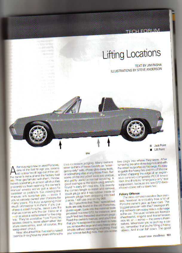

There is an article in the new Excellence August,on this very subject. It even has pictures.

boxtr, can you scan that excellece article and post?

heres the page from the article in Excellence of the 914...if you want i can post the whole article..its got good advice on jacking the car in other areas too

that looks like it's pointing to the donuts... are there other jackstands that fit in/on the donuts? the tops of mine are sahped like a rocking horse leg (kinda flat and thin with aslight dugout...

Wayne, I use the donuts on the front. This also shows how these jack stands fit perfectly into the donuts, I got a set at Sears and another set at Walmart.
