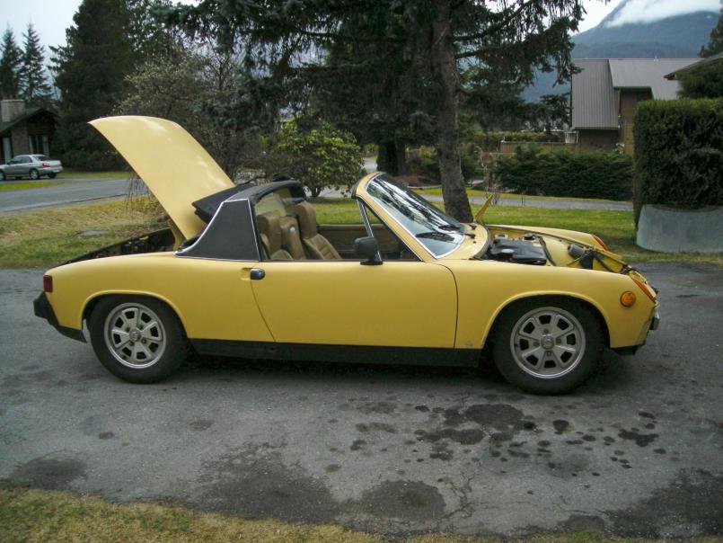

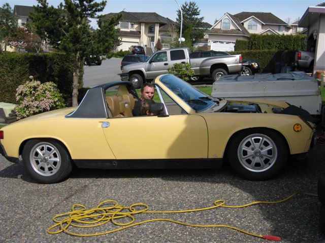

Here's me...Happy but concerned
The real VIN on all locations on the car is 4742916991, the VIN on the title was 4742916691. Yup, 1 digit off and he managed to get it across the boarder and claimes he didn't know ( I belive him and blame the border gaurd that didn't come out of the building to inspect the VIN)

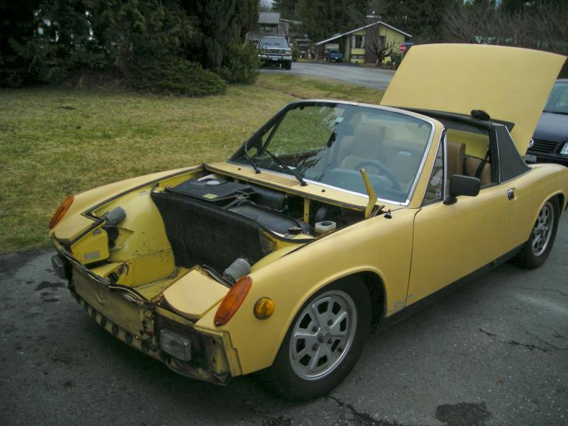

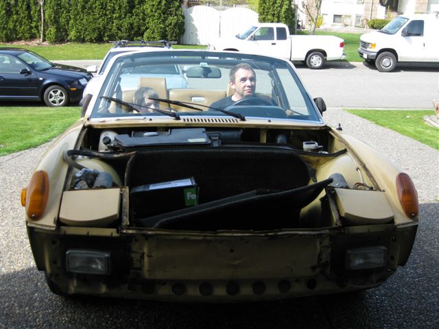

The details on the car are: 74' 2.0 Tan interior but sporting a 98 colour code and with some investigation was found to be Porsche 516 Sahara Beige. Frankly a Blaaa colour that the 74' Carerra's used.
The body was amazingly solid in all the spots I had been warned about. It was obvious that it had been in an MVA and rear ended someone. the front bulkhead was toast and the light boxes where bent. It was missing a hood and the seal channel by the windshield was damaged by the hinges in the accident.
The issue with the VIN was just beginning!

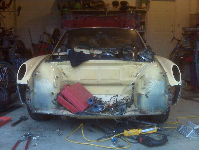

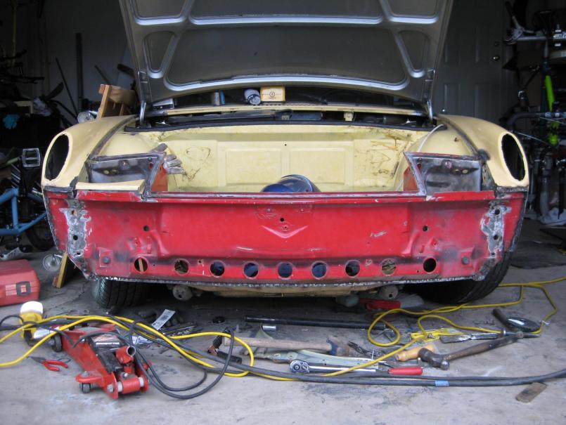

First order of business, New bulkhead and my first experience with drilling out spot welds and what seemed like hundreds
The tricky part was making sure the hood would line up when everything was welded together. I spent hours looking for pictures of bulkhead/hood alignment.
When It was done, it was close to perfect.

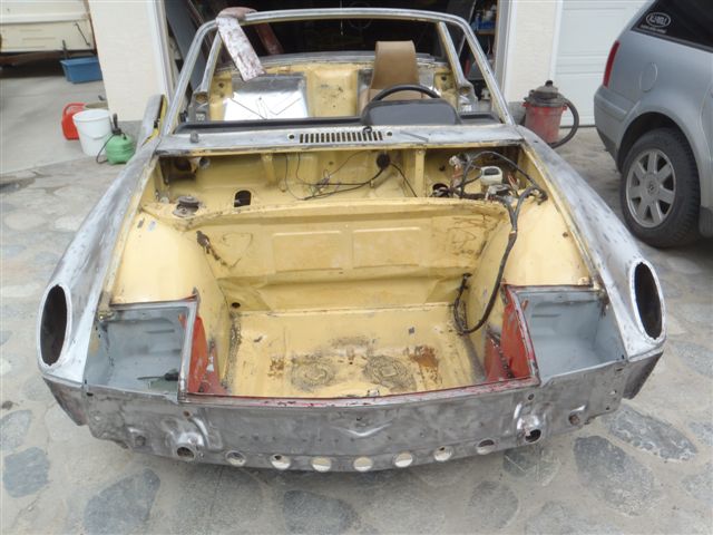

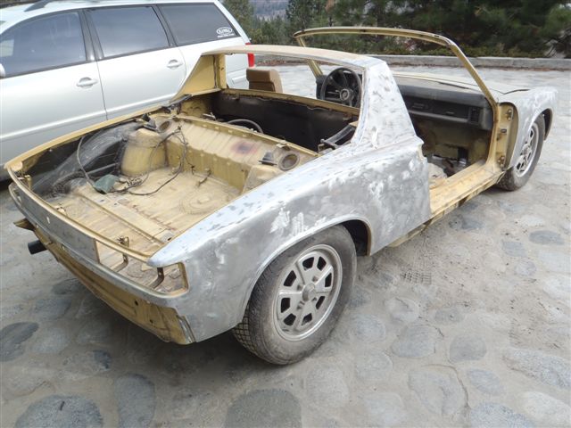

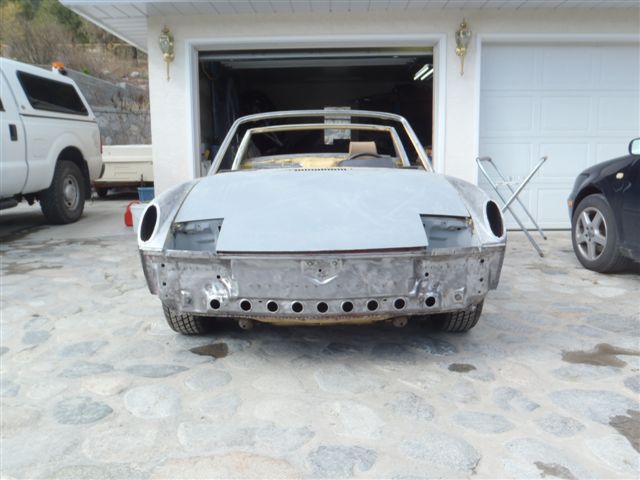

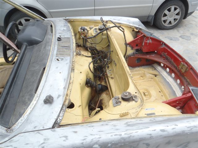

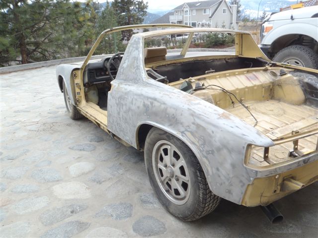

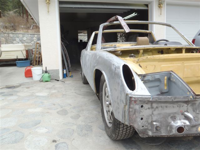

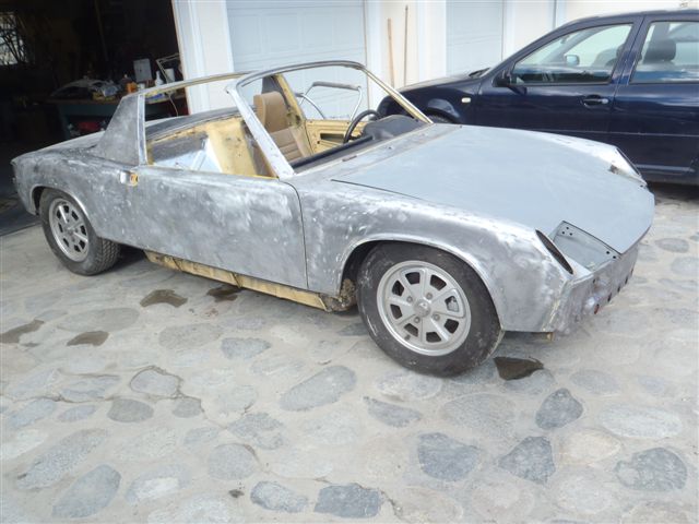

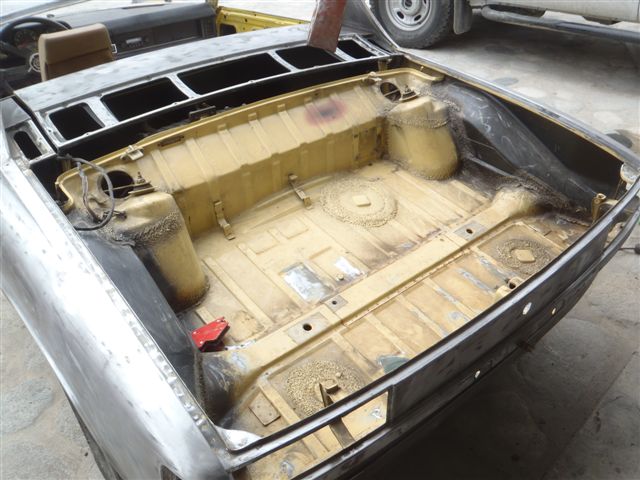

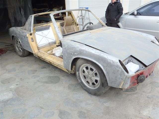

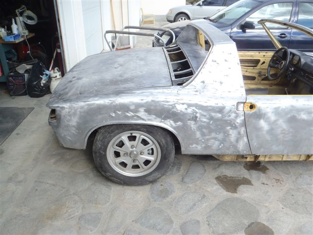

In the middle of all this I moved from the lower Mainland to the Okanagan. So things got way laid for a few months. I finished all the rust repair, filled in all the extra holes that these cars get over the years and started looking for someone to do the bodywork.
Google to the rescue, turns out the VP of the local PCA is a bodyman/Painter and had owned a 914 (great guy). He came over had a look and suggested that I take it down to bare metal. He recommended that I sand it off with a variable speed polisher and 8" disc.
Let the sanding begin!

More Pictures:

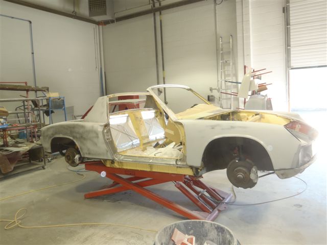

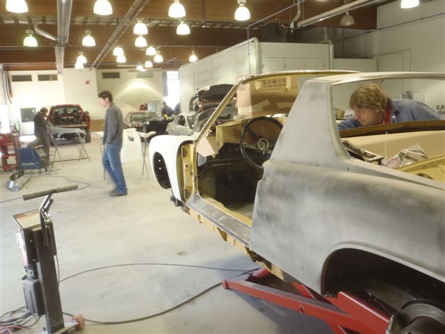

and off she goes to the body shop! (IMG:style_emoticons/default/cheer.gif)
Strudelwagon
post May 22 2011, 10:00 PM
Posts: 411
Joined: 11-October 08
From: interior, British Columbia
Member No.: 9,633

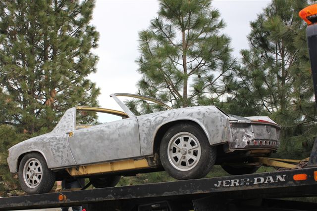

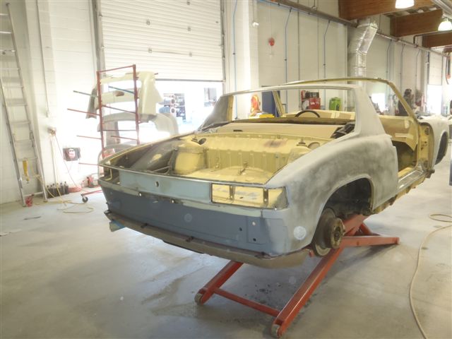

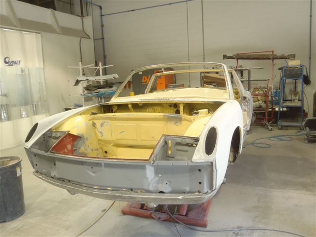

Last week at the body shop:

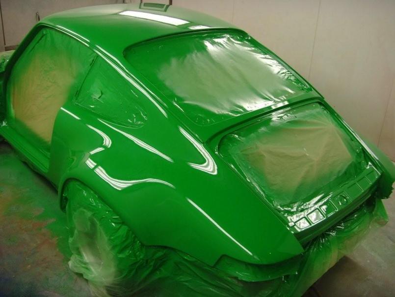

Just so the purist aren't too shocked...I can't live with the original colour. It's just not me! I've owned alot of cars but none are "Beige" She's going to be Viper/Emerald Green.

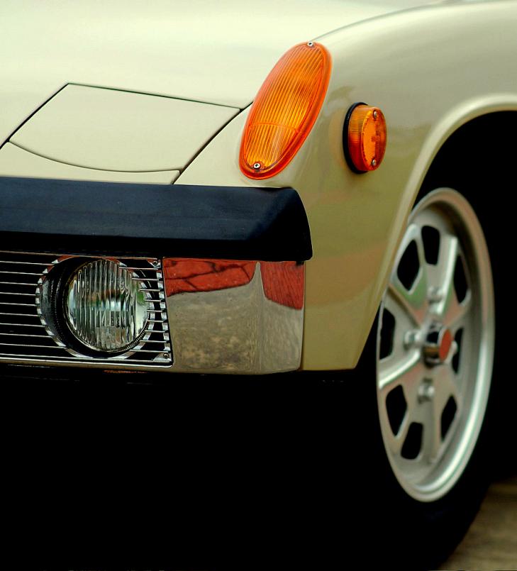

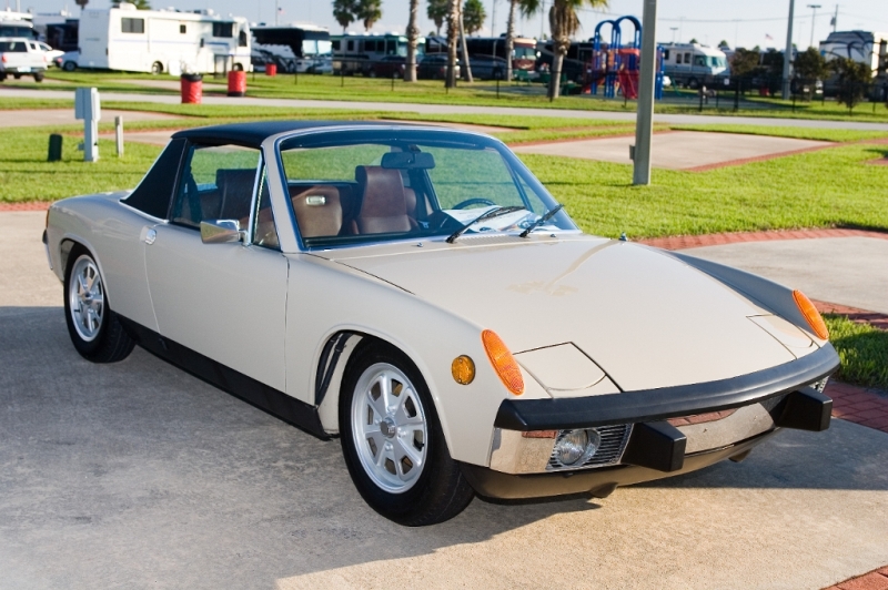

Sahara Beige 73 2L in the capable hands of "preservationist" Steve G/smg914:
http://www.914world.com/bbs2/index.php?showtopic=101921
Here's a few shots of the finished goal - if you're going to stick with the more unique/valuable 98 paint code in Sahara Beige, & his looks pretty good all cleaned up! (IMG:style_emoticons/default/drooley.gif)
BTW - Steve's has the Brown interior, but you've got the #31 Beige interior with #501 Basketweave & #501 smooth Leatherette, and either #503 Dark Tan or #504 Loop Pile Carpet (assuming it's got the Appearance Group).
http://bowlsby.net/914/Classic/PaintFabrics.htm
Nice Find! (IMG:style_emoticons/default/smilie_pokal.gif)

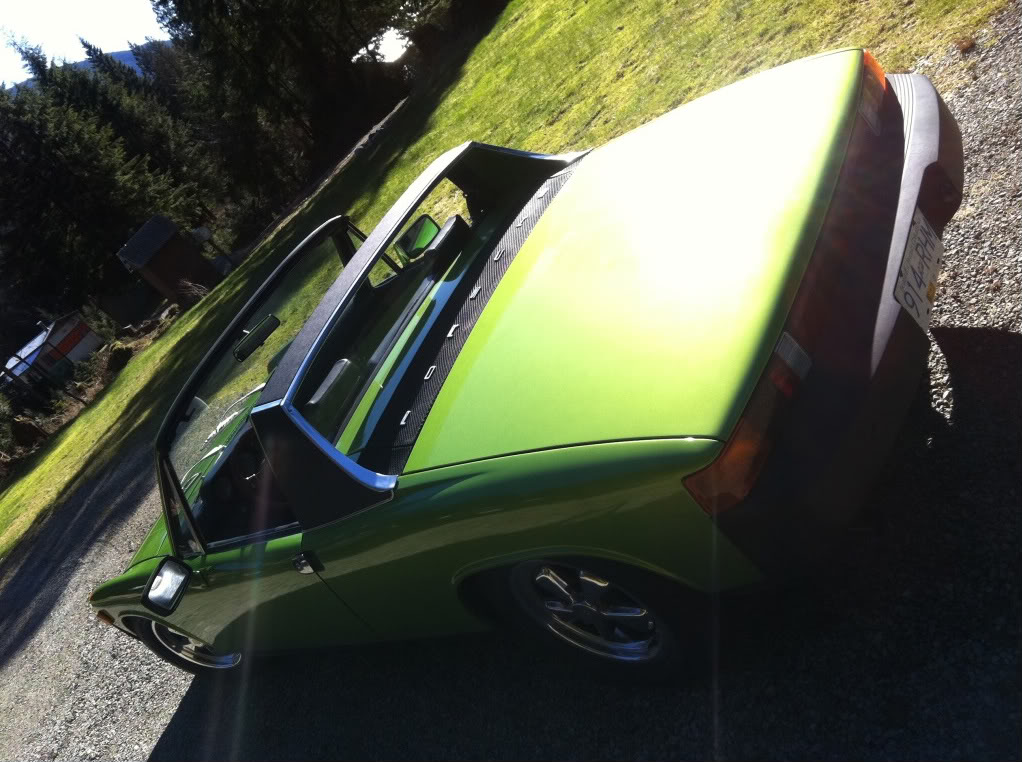

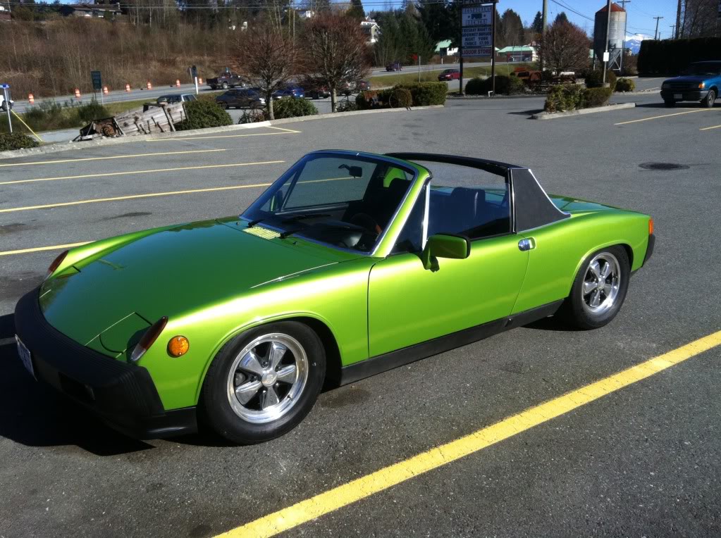

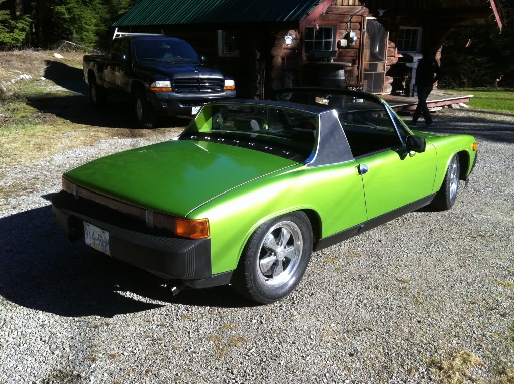

How bout Lime green mettalic?L98B?
(IMG:http://www.914world.com/bbs2/uploads_offsite/i211.photobucket.com-12137-1306130752.1.jpg)
(IMG:http://www.914world.com/bbs2/uploads_offsite/i211.photobucket.com-12137-1306130753.2.jpg)
(IMG:http://www.914world.com/bbs2/uploads_offsite/i211.photobucket.com-12137-1306130753.3.jpg)
It aint so bad!
Looks good Strudel!Cant wait to see the after pics.Im going to have to burn up to the OK to see it in person.Nice work. (IMG:style_emoticons/default/aktion035.gif)

Nice looking ride Speed. Lime metallic looks great on a 914. I still have along road before I can burn anywhere. Reassembly and then MVI (inspection) b/c she's from out of province.

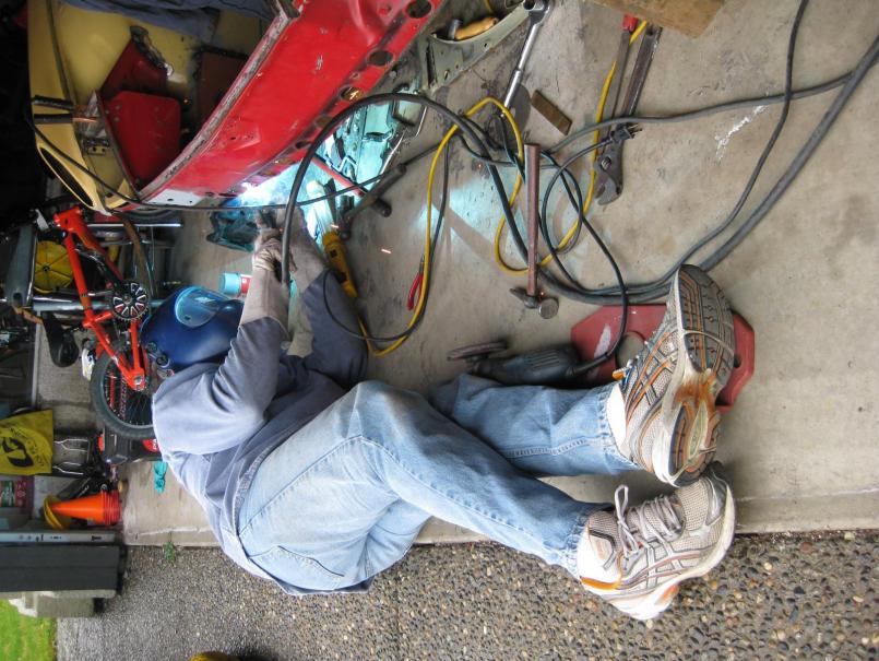

Just in case you wondered if I was having fun.... here's me laying on the cold cement making sparks... that smell is burning flesh

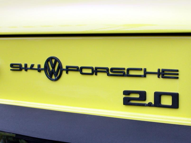

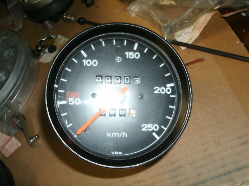

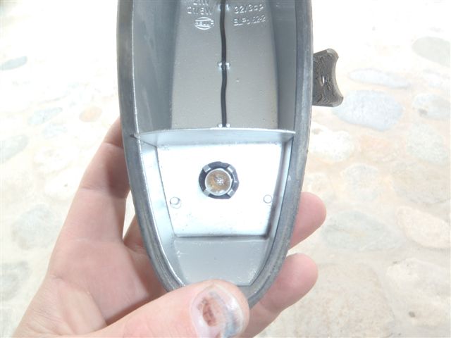

The goal on this build is to have a Euro Spec (or as close as) 914. So, some of the things I need are sometimes hard to get. Like that 250kmh speedo I just missed on ebay...Dammit! Another member here got it.
I did score a VW/Porsche thingy for the rear at a smokin deal from a member
like this.
My quest to get that front signal look had me bending and cutting aluminum for a reasonable replica light pod mod.
Yes, that thumb was a victim of a body hammer (IMG:style_emoticons/default/headbang.gif)

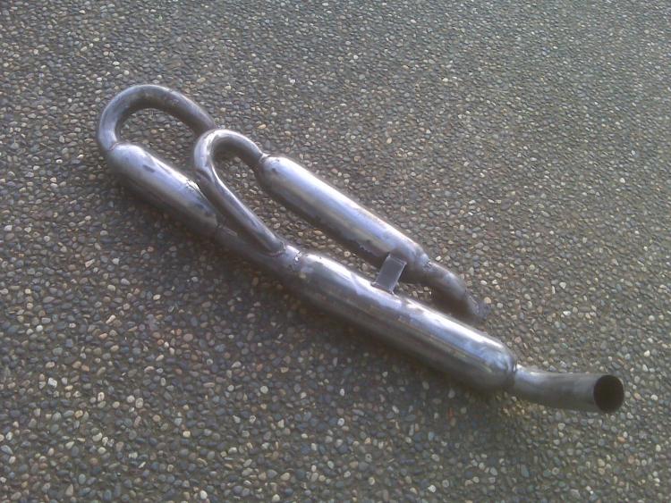

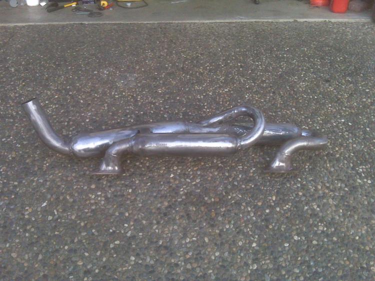

It also came with this early TRIAD single outlet exhaust. Pretty sweey eh?
The sound is pretty bad ass!
I hit it with some BBQ flat black paint and it looks great (IMG:style_emoticons/default/shades.gif)
