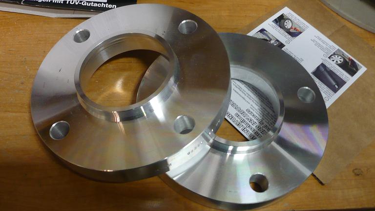

I have just orderd some wheel spacers for the front of my 914. They are 4 X 130 20mm spacers. These should bring the front wheels to about the same track as the rear, filling in the front wells. I am just doing it for looks. (IMG:style_emoticons/default/smile.gif)
My question is the stock lug bolts are 38mm R14 ball seat. With these spacers I need to add the 20mm length. The closest I have found are radusadirect.com and they are 58mm R14 ball seat. I was about to order until I read some threads that stated studs and nuts are better???
what is the benefit? Are the 58mm bolts dangerous??

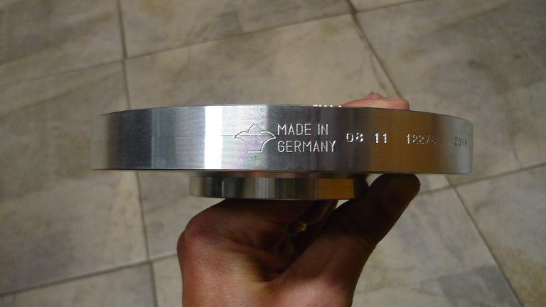

11 days from time of order to sitting on my desk. And they are sooooo shiney (IMG:style_emoticons/default/drooley.gif)
still waiting on my longer lug bolts, then I will pop em on. (IMG:style_emoticons/default/piratenanner.gif)

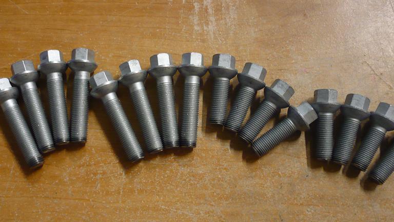

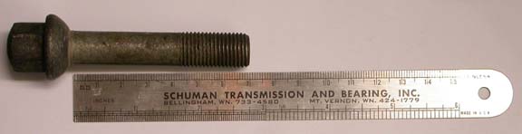

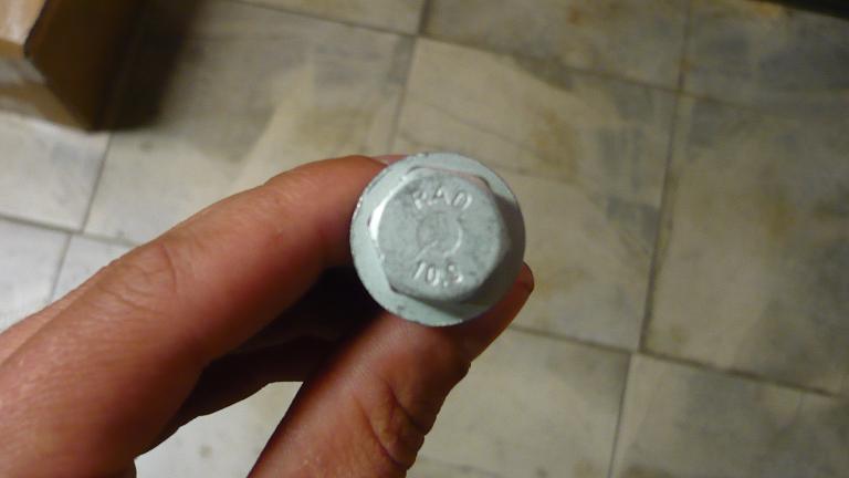

Is this the type of bolt you're using?
I have 16 of these if you're interested.

QUOTE(KELTY360 @ Jun 27 2011, 04:49 PM) *
I have already orderd custom length bolts from Rad USA Direct, very nice guy. They are cutting me bolts for all 4 wheels. (IMG:style_emoticons/default/smile.gif) Thanks for the offer though (IMG:style_emoticons/default/beerchug.gif)

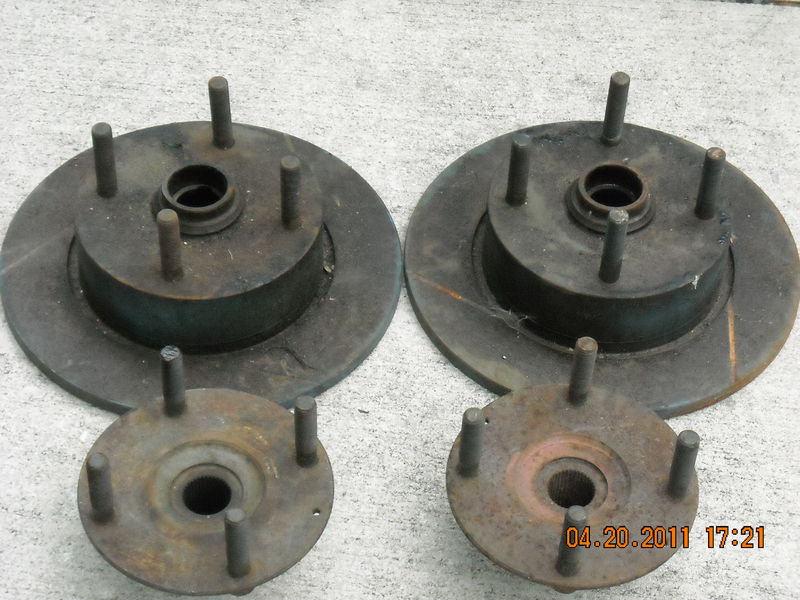

racerbvd
post Jul 7 2011, 09:21 AM
Posts: 2,381
Joined: 3-February 03
From: Sunny FL.
Member No.: 226
I used 930 wheel studs when I was doing a project like this, maybe not the chearpest studs, but proven and easy to find.
(IMG:http://www.914world.com/bbs2/uploads_offsite/forums.pelicanparts.com-226-1310052115.1.jpg)
