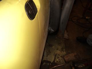

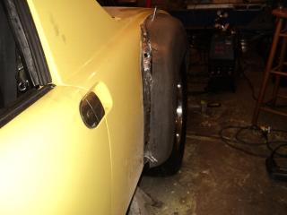

Well after over two months it has finally arrived. (IMG:style_emoticons/default/piratenanner.gif) Guessing a lot of you are already familiar with this car. Previous threads are 914-6 Carrma and WOW, my "solid" car aint so solid, but now it is solid!, It is off jack stands!!!.
I bought this car for two reasons.
First, back on moaners day 2010 my 76' was rear ended. Got a rear clip for it and was going to have Area 51 Werks straiten it out and put on my AA steel flares. This car handled most of that need. (flares will still need to be done)
Second, I was planning on doing the five lug conversion. Had the parts to convert the 914 suspension to a five lug. (Modified 914-4 parts) This car was a huge upgrade as T.C. had converted it to a 911 setup both front and rear.
Those of you who know me already know this is a car for my son Dan, as I am legally blind and for some reason the stare of Minnesota would rather I not operate a vehicle on the roads..... (IMG:style_emoticons/default/biggrin.gif)
After some thought and checking Dan's finances (Porsche Purists Skip this paragraph) We have decided to put a 1966 Corvair 180 turbo in it. This engine will be modified slightly. Heads will have stainless valves and angled exhaust ports. Cam has been custom made by Cower Cams for more torque in the mid range and high end. Just waiting on the rebuild kit from Corvair Underground. We also will be changing the draw through Turbo to a dual carb blow through system. We have asked Steve Goodman (Corvair Guru) for advice as we started down this path.
Set a goal to have it road worthy by the RRC this fall.
Here are some pictures, sorry my son took the pictures and can not seem to center the subject.

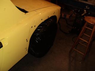

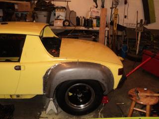

Well after 5 months and still waiting for engine parts. (Another story but if your looking for Corvair engibe parts, i can tell where mot to go) The car is up at Area 51 Werks to get the flares on. (IMG:style_emoticons/default/welder.gif) (IMG:style_emoticons/default/piratenanner.gif) (IMG:style_emoticons/default/piratenanner.gif) (IMG:style_emoticons/default/piratenanner.gif)
We found 255x60x15 to go on the 15x9 rims that came with the car. Well with that sized rubber and rim Rick had to add almost 2" to the rear flare's. (IMG:style_emoticons/default/sawzall-smiley.gif) (IMG:style_emoticons/default/smash.gif)
We will need to modify or build new rocker covers (IMG:style_emoticons/default/idea.gif)
Also when he placed the front ones up for fitment, noticed they will need to be modified also. Sloped nose car. so more (IMG:style_emoticons/default/sawzall-smiley.gif) (IMG:style_emoticons/default/smash.gif)

(IMG:style_emoticons/default/assimilate.gif) I'll post some larger photos if Irv and Dan give me the OK. I would show you the work required to reshape these flares but inprogress photos would likely freak you out. They look really fuggly before they look good.

Here ya go guys. Here's a couple from the first day. The rear track is fat so I couldn't just install the flares as everyone else. The sharpie line is where the flares fit without modification. I moved them almost 2" out from the line. These first two photos will kind of give you the impression that I ruined a good set of flares and it will be a miracle if they are even useable anymore. No worries. (IMG:style_emoticons/default/shades.gif)
(IMG:style_emoticons/default/unsure.gif) (IMG:style_emoticons/default/unsure.gif) (IMG:style_emoticons/default/unsure.gif) (IMG:style_emoticons/default/unsure.gif) (IMG:style_emoticons/default/unsure.gif) (IMG:style_emoticons/default/unsure.gif) (IMG:style_emoticons/default/unsure.gif)
I am butt welding these and shaping them as I go. I find it easier to tack them over the stretched lip of the original panel then cut through and hammer and dolly the two edges to line them up, then weld the gap. Here's the underside showing the waste strip I pull down as I move about 3-4" at a time.
The next set is showing a bumping tool I use to shape the panel as I go. I bump the low spots with this tool and a pointed one I have, hammer and dolly the highs and file the panel.
This is as far as I got today. It's starting to take shape.
And here you can see how much I had to modify the flares to fit the fatness. Lots of welding, grinding, planishing and filing before it's done.
