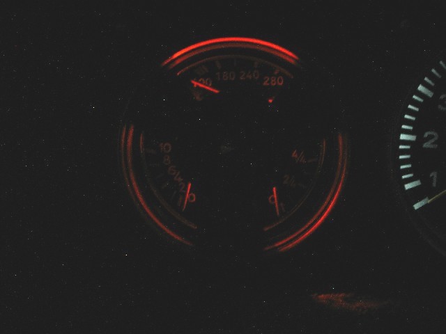

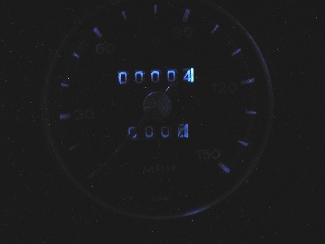

I received the LED prototypes in today. Red, Blue, and Superbright white. The superbright white is really just a wavelength of blue.
I can honestly say they are not any brighter than the incandescent bulbs. The good news is that the inverted lense actually disperses the light about the same as the incandescent bulb, thus doing away with problem that the LED lights are directional in natuure.
I think that the size of the LED is the issue. I big LED will most definitely be brighter, but you run into size problems with the lamp base.
It has only three advantages I can think of.
1. Last longer
2. Color choices
3. Will not fade and yellow over time.
So... I don't think it is really worth going through the expense of importing some in from overseas.
Sorry to get everyone's hopes up. I guess that's part of the experimentation process.
I am still waiting to hear back about the halogen fog bulbs though.

Do the lamps have external current limiting resistors on the LEDs?
Do you know if the manufacturer is running them at peak output (might be a trade in lifetime)? Have they considered heatsinking them (using the gauge body) to run higher power, or maybe pulsing them?

Supposedly they have the resistor integrated to be compatible with automotive electrical systems. Not sure about the "peak" voltage issue.
I ran them from 12 volts and also from 9 volts (just to see) and couldn't tell any difference in brightness.
As far as providing power to them, I tried two methods... using the gauge body as ground and postive voltage to the end of the light.
I also tried a different bulb receptical with seperate postive and negative leads.

I can get ANY type of bulb made.
Xenon, halogen, LED.
Should I look into getting these bulbs made with a different type of gas, like Xenon? I'm sure the manufacturer can make a regular gas bulb, but use a brighter gas. But then you run into heat and voltage issues.
Maybe the limitation is just the gauge design. There is only so much light that can creep around the edges of the gauge faces.
I am very frustrated. Ugh!

Unfortunately, my digital camera doesn't take the best pictures of dimly lit objects.

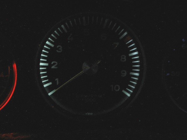

Here is the tachy
It is actually brighter than in the photos. Just not any brighter than new OEM bulbs.

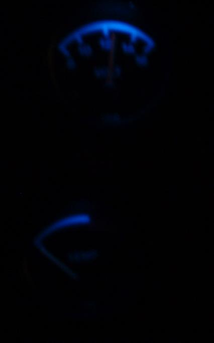

Qarl
post Jun 21 2004, 08:03 PM
Shriveled member
Posts: 5,233
Joined: 8-February 03
From: Florida
Member No.: 271
blue

Hi!
Just thought I'd post some pix of an experiment I did with some 10,000 MCD Blue LEDs. I got them on ebay from a guy in Hong Kong. No problem w/ shipping. You are looking at a temp gauge and a voltage gauge. There are 3 leds per gauge.
Just use a 330 ohm(*1/2 watt) resistor per ea. easy to get, easy to solder. Use shrink tubing to keep them from shorting.
*These LEDS use 423mW @ 12v...3 of them use 1.3w... The stock bulbs use 2w so there is no need to worry about the fuses.
